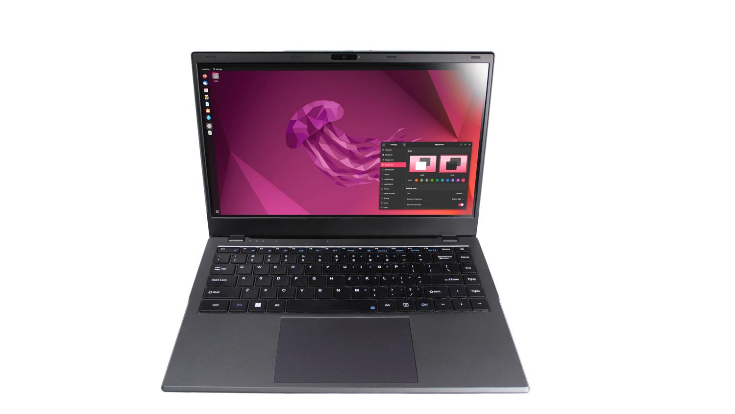

$700?
It’s an ARM CPU laptop, not compatible with Qubes OS which only supports amd64 / X86_64 CPU architecture.
Yes, I know. It was just a teaser for the devs, hopefully :slight_smile: :grin:
This is a Xen limitation, not really Qubes OS itself.
In general, arm64 support is pretty bad because boards can be really different from one to another. Laptops using arm64 on the market are unfortunately often using out of tree kernel code and you end up with updates support similar to what you have with cheap Android smartphones :frowning:
