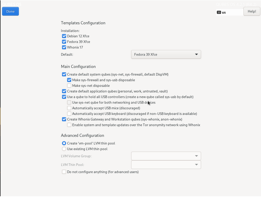

after I manually forced to restart computer, I have never seen the screens down below which have been instructed by Qubes OS web side. then, it complete the installation suddenly with no signs, but nothing work, even terminal screen to make something.

After first installation completed, Qube installaation drive me to re-boot the computer and when I did reboot, screen stay in black and with mouse’s arrow cursor. THen I have to force for rebooting by pressing on/off button to restart computer.
So, later GRUB screen coming with choice UEFI or Qubes installation and Advance Qubes installation then I choise qube installation.
But, after hard drive encription password and user password it jump to normal start it passes the initial configuration screen.
When sytem starts nothing starting. even terminal screen, dom0 even not working. I can only on or off the computer.
I have tried many times, with latest kernel, without kernel, repair installation nothing changed.

Thanks alot ChrisA, have installed that May be 10 time and coupl of time I have sweept Hard Drive from bios too. But nothing happened. After First installation it should jump to initial configuration but it has not. It juat boot up with no configuration and it dalaşı es not let me make any changes.
Main menu is not working only dom0 comes but rest is not.
