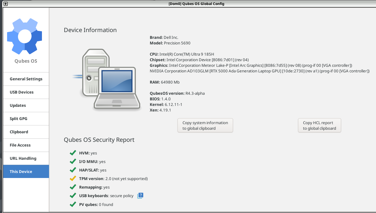

Hey everyone,
Just a heads-up since I’m also testing the 4.3 release, since I have some HW compatibility issues running Qubes stable on a Dell Precision 5690 (nov 2024).
I’ve downloaded the testing iso Qubes-4.3.202502042300 from here.
Installation went smooth, no issues to report.
As far as my Qubes usage is ongoing, I haven’t encountered any issues, but I’ll post them if any.
Edit: Should I submit a HCL compatibility report for this, although it’s 4.3 ?
That is awesome. If would be great if you could post the HCL report as well. It would be extremely helpful to other users
2 posts were split to a new topic: Dell Precision 5690 (Qubes 4.3 alpha)
