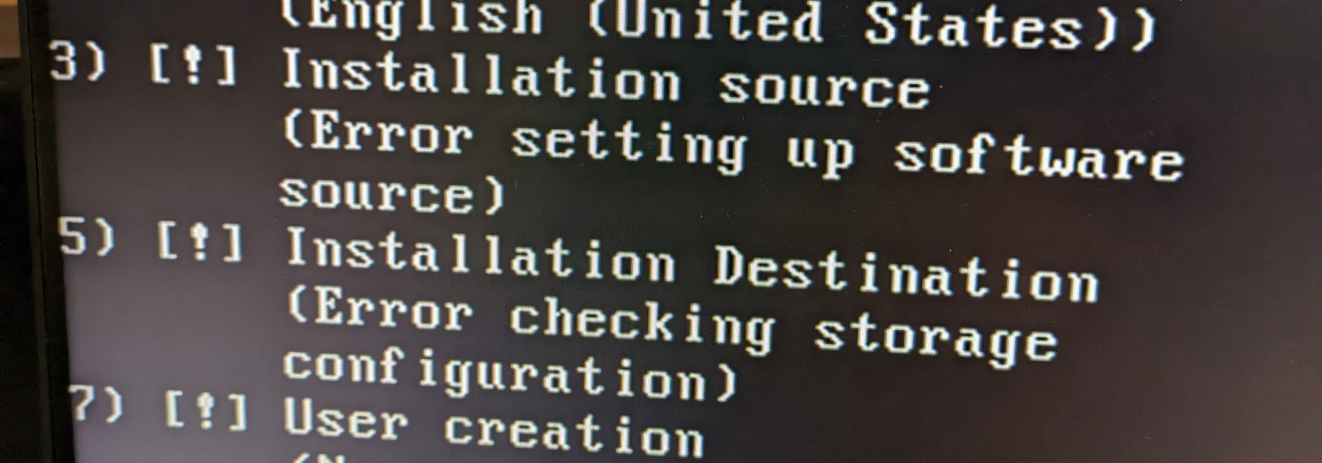

This lead to sth new: Now i saw this checking devices or so (running with like 0-100%), which did not pop up for me before. Once that finished tho, the system always came to a black screen.
Then I started the system with nomodeset and init.text(or similar, for text mode) and i got the tmux shell. There i tried multiple nogui installs (also using anaconda --text), where i’ve got told that 1st: The installation failed from local files and also doesnt work from known mirrors online, and second that there was some problem with the disk set up or drives. Therefore i couldn’t continue the installation.

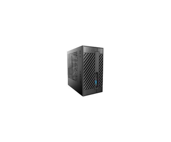

The error messages are inside of the text installer and visible in the image. The graphical stuff just freezes, and i could never really find anything with journalctl or similar. I am using a deskmini 110 pc, just a standard mini pc.

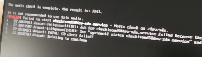

When you run “Test media and install Qubes OS”, was the test successful? Did you see the Checking: x.x% going from 0% to 100%?

Shortly before the checking ended at boot, the checking terminated and there was an error. It disapperared so fast that i had to make a video to catch it: CD check on dev sda failed! I am thinking more and more that i have to try installling the installer os on the usb again, this time maybe with rufus and a different usb drive.

Now it takes like 8 minutes of a screen with an empty prompt showing until the system really boots. Once it boots i can again use the text installer, where the installation source and mirrors thing seems to work fine now. But there is still this error with checking disk configuration, like visible in the (previous) image. Then there is still the cd check failed error and the black screen when trying it with the graphical environment.

Here are some specs(look at barebone):
