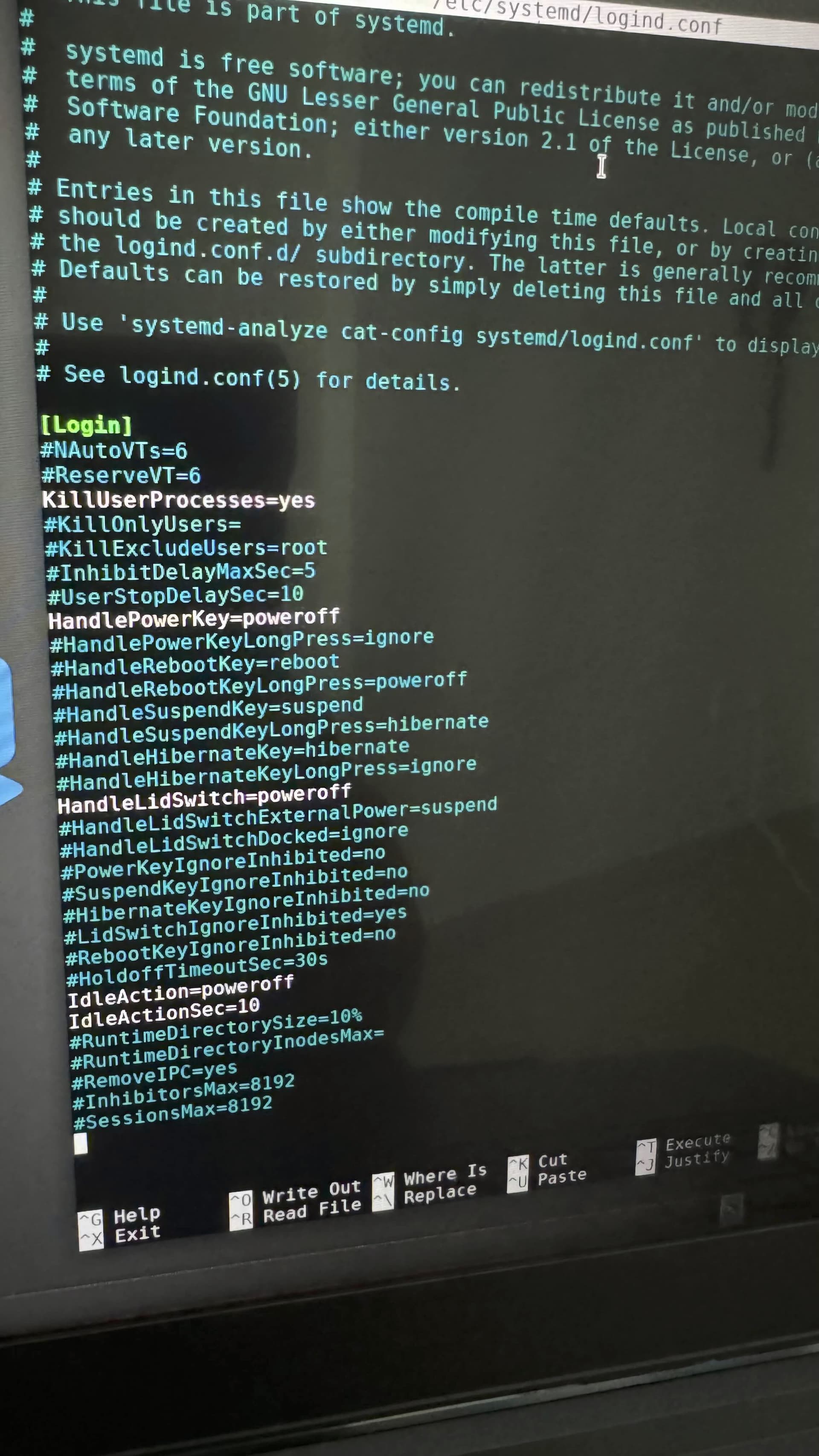

For anyone in the future who screws it up by setting it to 10 seconds and not 10 minutes on a CoreBoot+Heads device… here’s something you can try!
Situation
  • You accidentally set it to shutdown on idle with 10 seconds. :upside_down_face:
  • You can’t login because it’ll immediately shutdown before you see the login screen.
  • Heads probably soft-locked (DA lockout mode) your TPM due to too many reboots.
What's DA Lockout Mode
  • Triggering a DA lockout: If the system is abruptly or improperly shut down multiple times, or if a user fails to enter the correct passphrase too often, the TPM’s internal counter for failed authorization attempts can be triggered.
  • Preventing key unsealing: Once in DA lockout mode, the TPM will block attempts to unseal keys, even with the correct passphrase, to protect against potential dictionary attacks. The system will then be unable to unlock the encrypted disk and will fail to boot.
(IMG) Shutdown on boot
Resolution
  1. If the device is soft-locked, turn it off and wait 30 minutes.
  2. Boot up the device.
  3. Press any key when prompt Automatic boot in 5 seconds unless interrupted by keypress...
  4. Arrow down and select Options -->
  5. Go down and select Exit to recovery shell
  6. Enter:kexec-select-boot -b /boot -a systemd.mask=systemd-logind.service
  7. Your device will now boot, ask for the encryption passphrase, and boot into Qubes at the login screen without automatically shutting down.
  8. FIX YOUR /etc/systemd/logind.conf !!
(IMG) Example of the error in my ways
Special Thanks
I would like to personally thank @Insurgo, @arraybolt3, and @marmarek on the Qubes OS Matrix channel for the immense help! :star2:
This was a great teaching moment for myself as this screw up helped me learn more about Coreboot+Heads, the Linux kernel, and Qubes OS!
