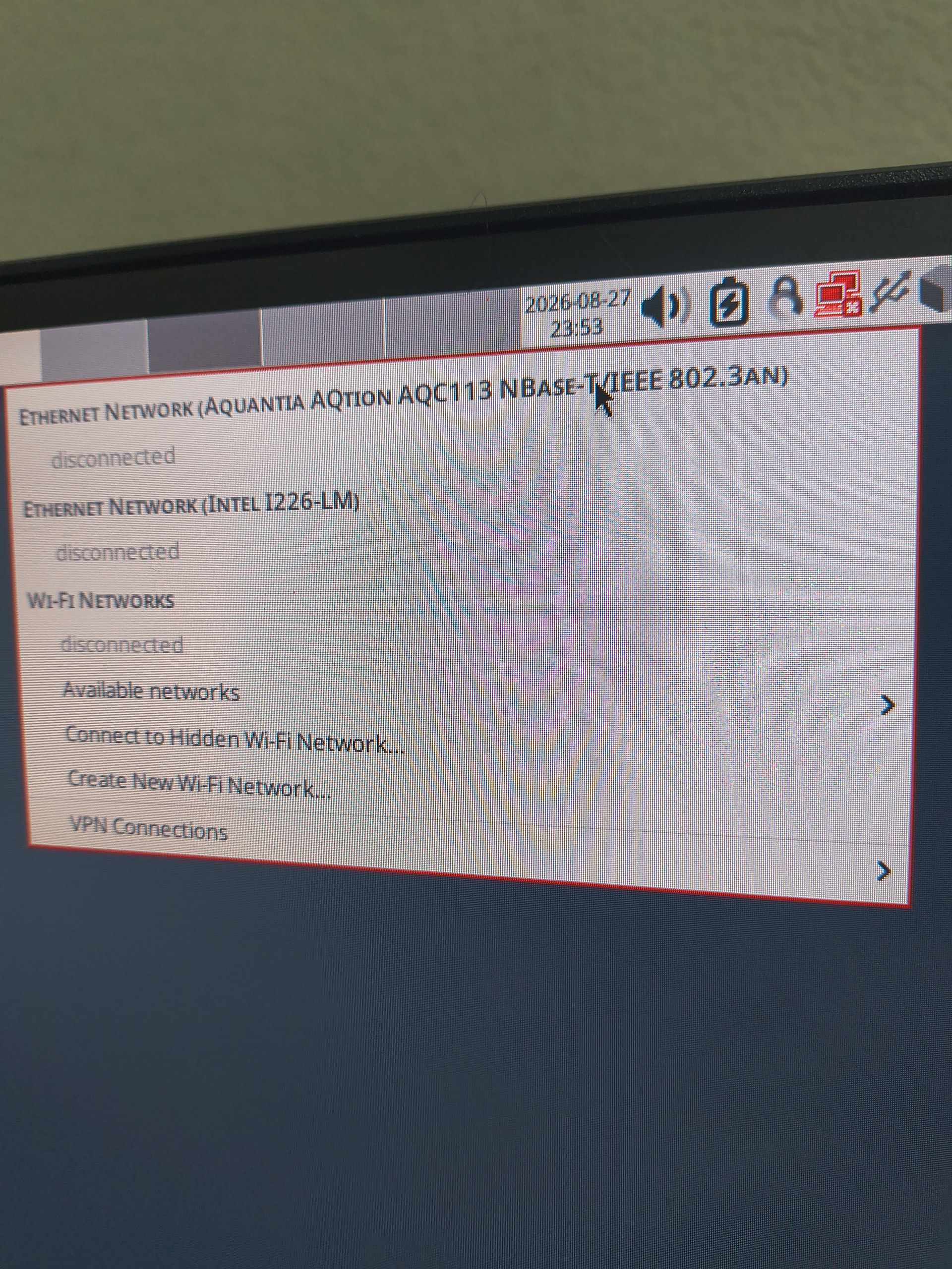

What PCI devices are attached to sys-net?
Maybe there is a problem with drivers for your network controllers and that’s why there is nothing in the network manager applet.

No, I mean Ethernet controller or Wireless network controller PCI devices.

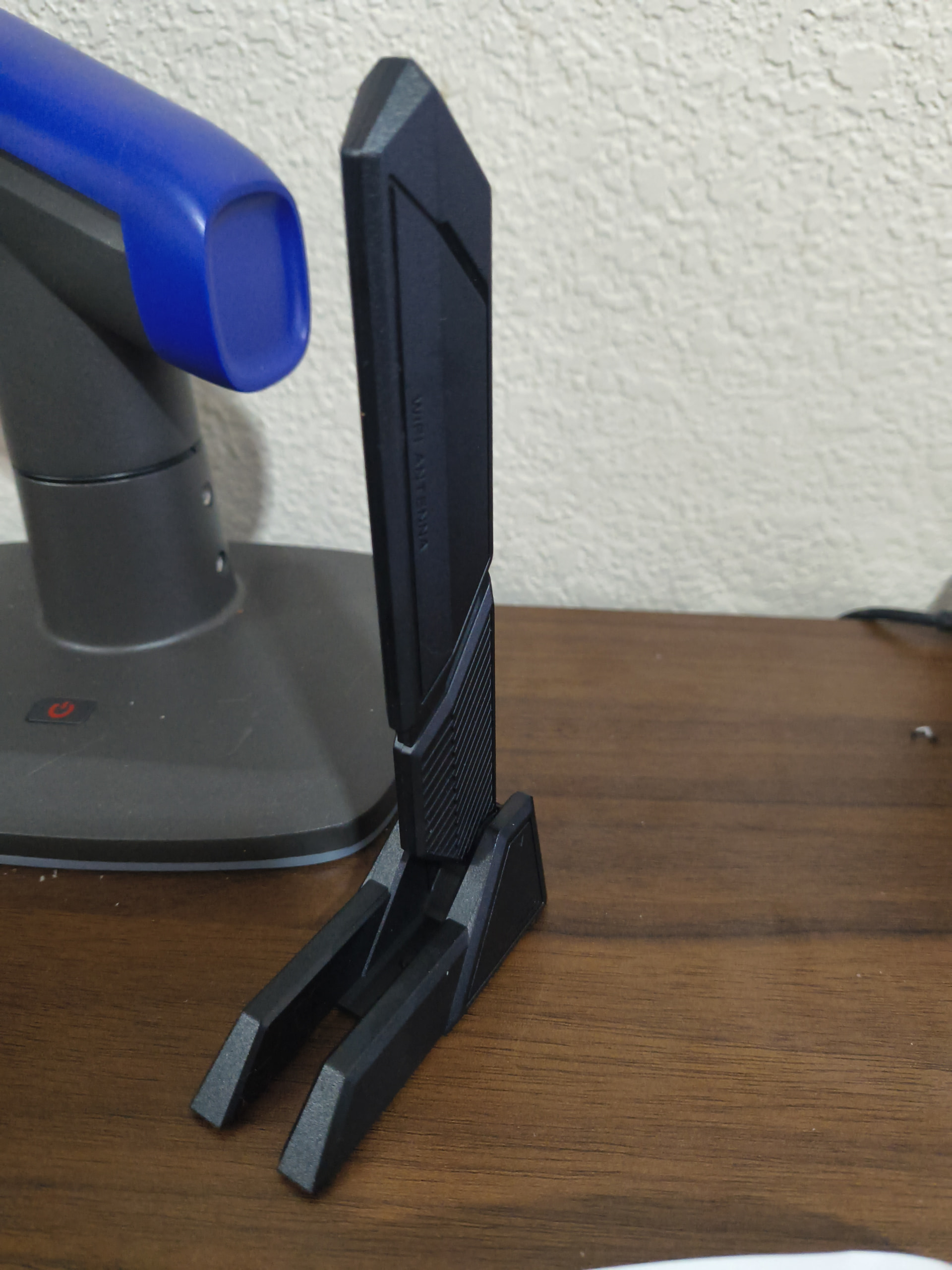

I have it just hard wired which worked at first then it dropped off and was using wireless which isn’t being recognized now either so I tried to install extender that came with the board which isn’t being recognized either.
What devices are listed in the sys-net’s Qube Settings → Devices tab under “Devices always connected to this qube”?

It should be safe. I want to know what devices do you have to check if there could be some known problems with their drivers.
Did you suspend/resume your computer? Some PCI devices have a problem with suspend and they stop working after resume from suspend.
You need to check the log in sys-net to see if there is a problem with your network controllers drivers.
You can check the log using sudo journalctl -b | cat command in sys-net terminal.

Wifi becomes available occasionally now. Could I possibly be missing one if these drivers in photo
Well, your adapters are identified, so probably no driver issue.
Sure, share the “long long results”, so far what you show and tell does not point to a distinct issue.
Maybe also try to have your wired connection use a static address instead of dhcp - would be nice to know if and how it also fails.
