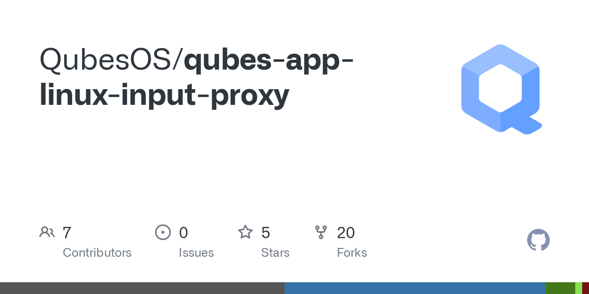

You said dom0 needs mouse to use it. But how mouse can be used by dom0 if mouse will be attached to sys-usb instead of dom0 so dom0 will not see it?
Yes.
Mouse can be attached from sys-usb to dom0 in the same way as any other USB device can be attached from sys-usb to any other VM.
This is not how it works currently. sys-usb can’t attach anything to dom0 for obvious security reasons. In the case of mouse/keyboard, Qubes sends the input through Qrexec using input-proxy-sender and input-proxy-receiver. The sender resides in sys-usb where the mouse and keyboard are, and the receiver runs in dom0 and filters the events sent to it based on a specific list of actions.

If you are using a USB qube, which is your case with the unified setup, it can’t attach anything to dom0. If it could, it wouldn’t make sense to use a separate qube for each USB controller. All events are sent to dom0 through a “proxy” instead.
