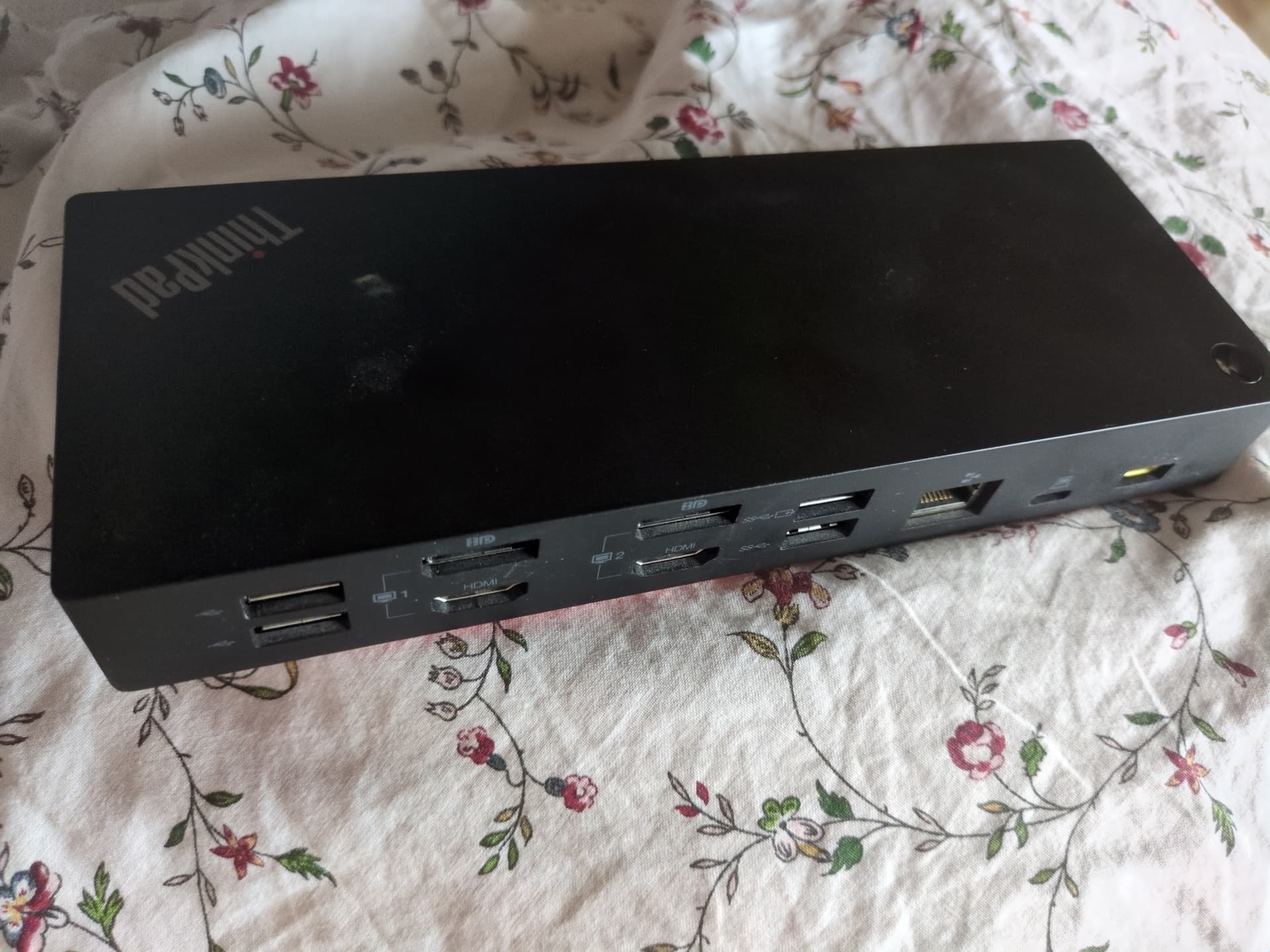

I have a Lenovo Thinkpad Hybrid USB-c with USB-a dock.
My configuration? I connect 2x DP monitors, a mouse and a USB keyboard to the dock.
I connect the Thinkpad docking station on one side with USB-c and connect it to the computer with the same USB-c cable.
The cable has a bandwidth of 10GB/s and works on Windows.
Behaviour: after connecting the station to the computer and then trying to load qubes, the computer restarts before the login screen appears.
After disconnecting all devices from the docking station, the problem still occurs.
After disconnecting the docking station from the computer, qubes started.
So I log into qubes - everything works fine.
Then I connect the docking station to the computer using USB-c - qubes works. I connect the keyboard and mouse to the docking station - qubes works, the mouse and keyboard are detected correctly.
However, when I connect DP monitors to the docking station, qubes does not see them.
  1. How can I change this?
  2. The second question, from a technical point of view: how do you actually debug it, which logs should you check?

Hi,
The station is connected on both sides via USB-C. I don’t know where you found the information that I had devices connected via Thunderbolt.
There is USB-C on both sides of the cable.
This docking station does not support Thunderbolt.
It seems that it’s DisplayLink device so it needs driver.
