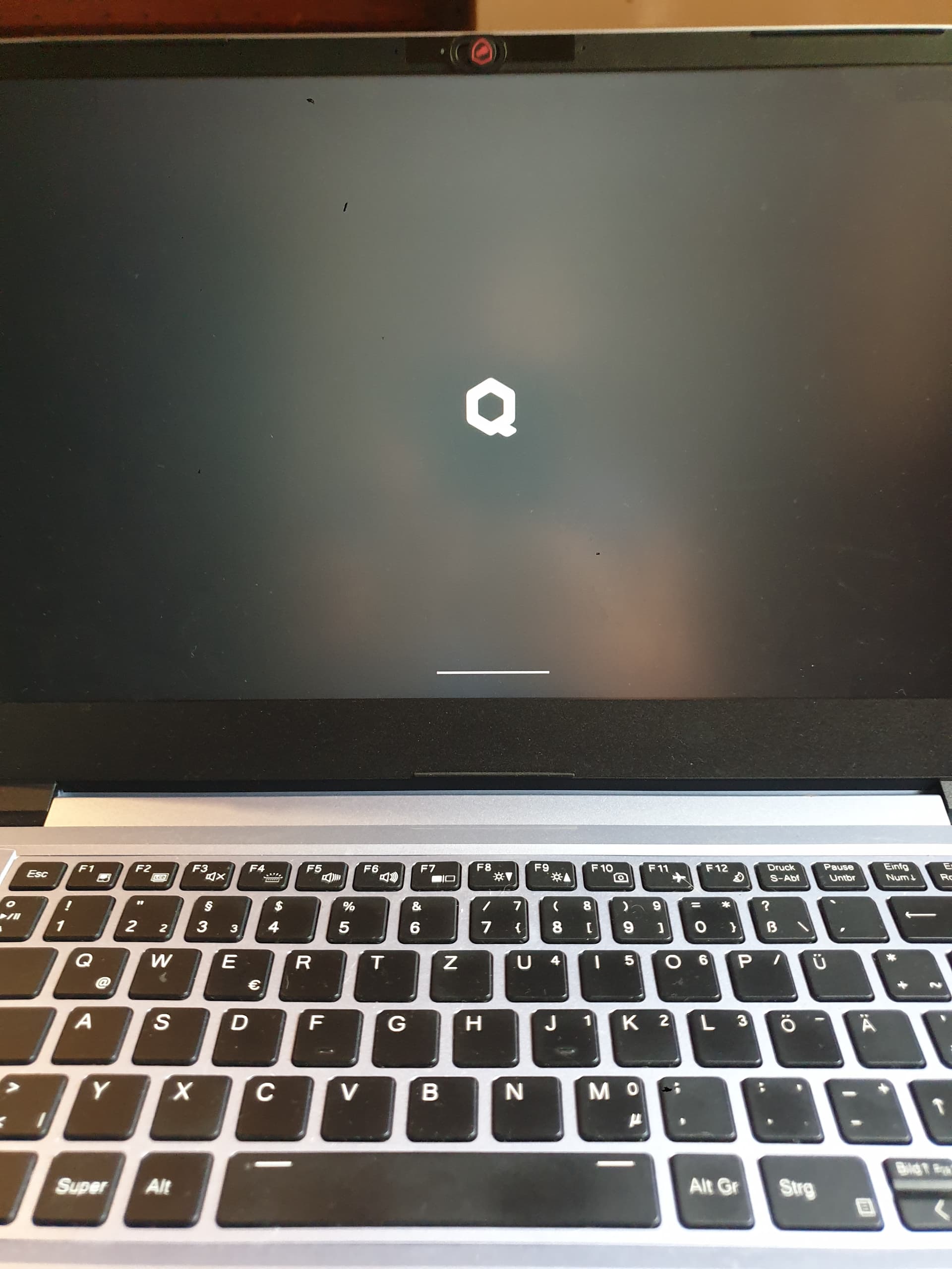

Hello, two days ago, the following problem occurred with my NotpadeNV41 laptop. In the morning, I was still able to work on it normally. I then shut it down normally. In the evening, I started the laptop to continue working. After entering the password, the loading process was fast until halfway through, then it became very slow. When the loading process was complete, the image froze and the desktop view wouldn’t load. Support hasn’t been able to help me so far, so I hope someone here can.

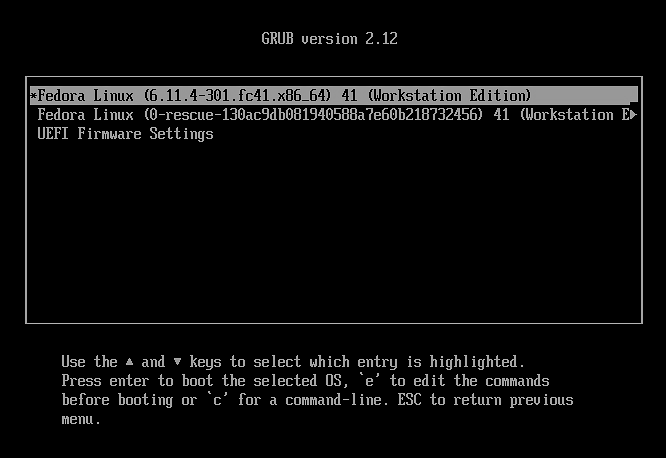

When you have the GRUB Boot menu, hit e to edit the boot options and use the arrow keys to find the kernel-line and replace quiet with cubes.skip_autostart.

I dont have GRUB
Oh - it wasn’t clear to me, how your system is configured/setup.

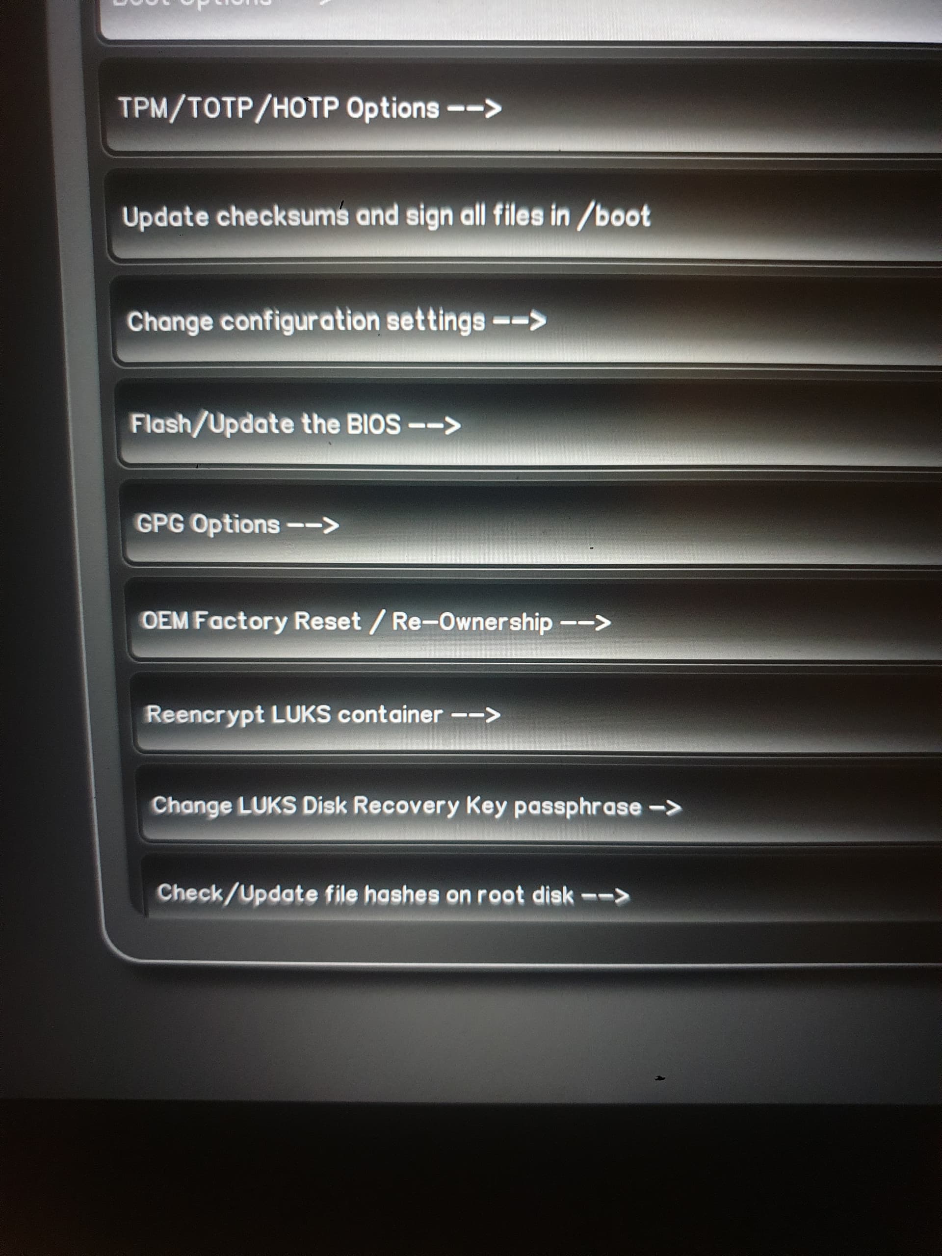

I don’t know where to find this information. I’m not that familiar with Qubes OS yet. I can only tell you what’s listed under System.info. FW_VER: Dasharo Nitroney -v2.4. Kernel linux 6.1.8-Nitrokey.

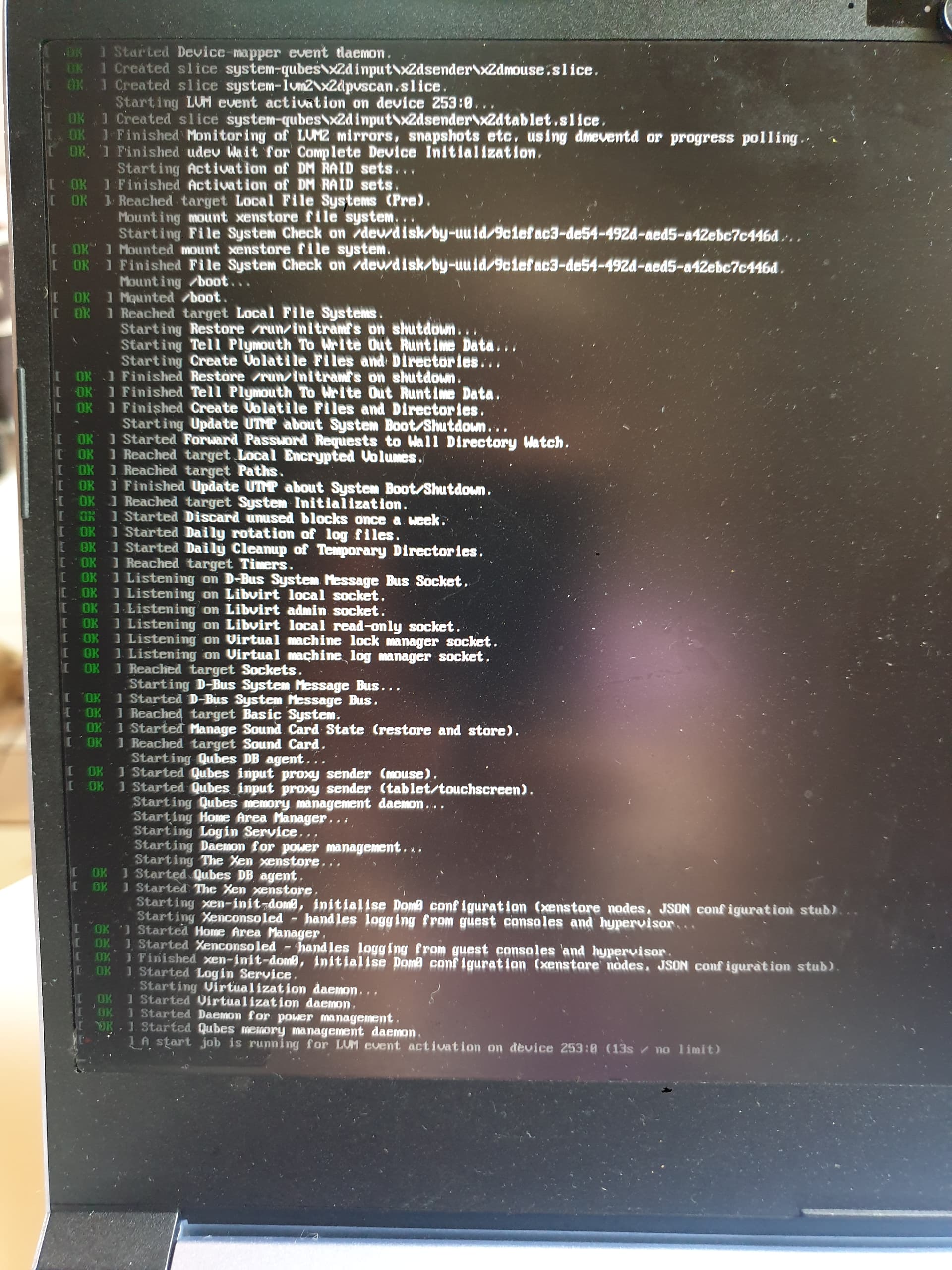

If you hit Esc key when at the part in your photo (after entering password and hitting enter), it should switch to the log and tell you where it is getting stuck. Take a photo

Yes, my nitrokey USB is connected. After entering the password, I pressed enter and then esc, and they received this information. See image.

LVM event activation on device 253:0
If boot is stuck at this message, then try to repair your LVM from some Live Linux OS:
Thank you. I can’t do anything with your answer because I don’t know how it works. I’m not a programmer, and I’m still learning about Qubes OS. Can anyone help me do it step by step?
