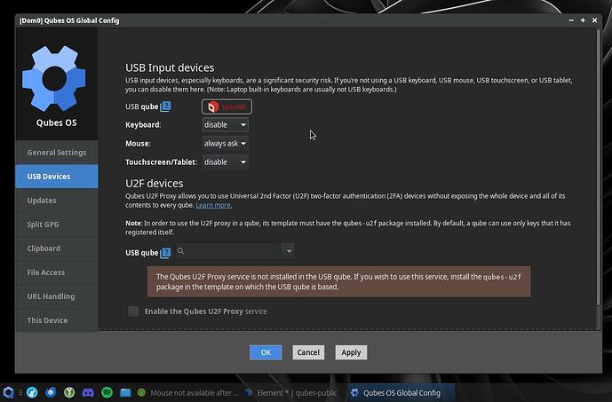

What does it show under USB Devices in the Qubes OS Global Config ($ qubes-global-config).
Mouse should be set to “always ask”.
Start → Gear Icon → Qubes Tools → Qubes Global Config.

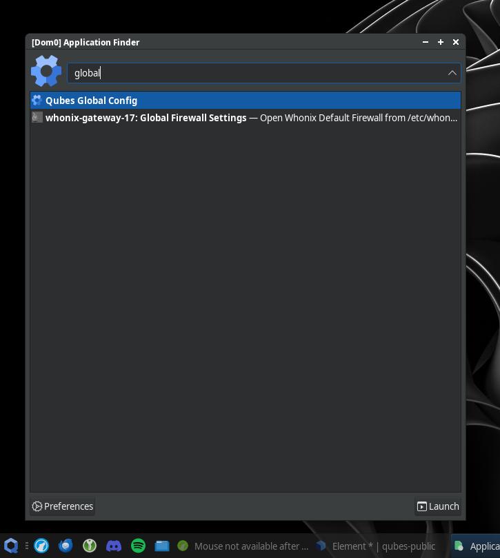

Hit Alt+F3 and search “Terminal” and hit enter to bring up the terminal.
But, since you’re already there, you could just type “Global” and the Qubes Global Config app should pop up.
Edit: Once the window opens, hit the arrow down key. Then you can hit Tab to move to ‘select’ other buttons/menus.

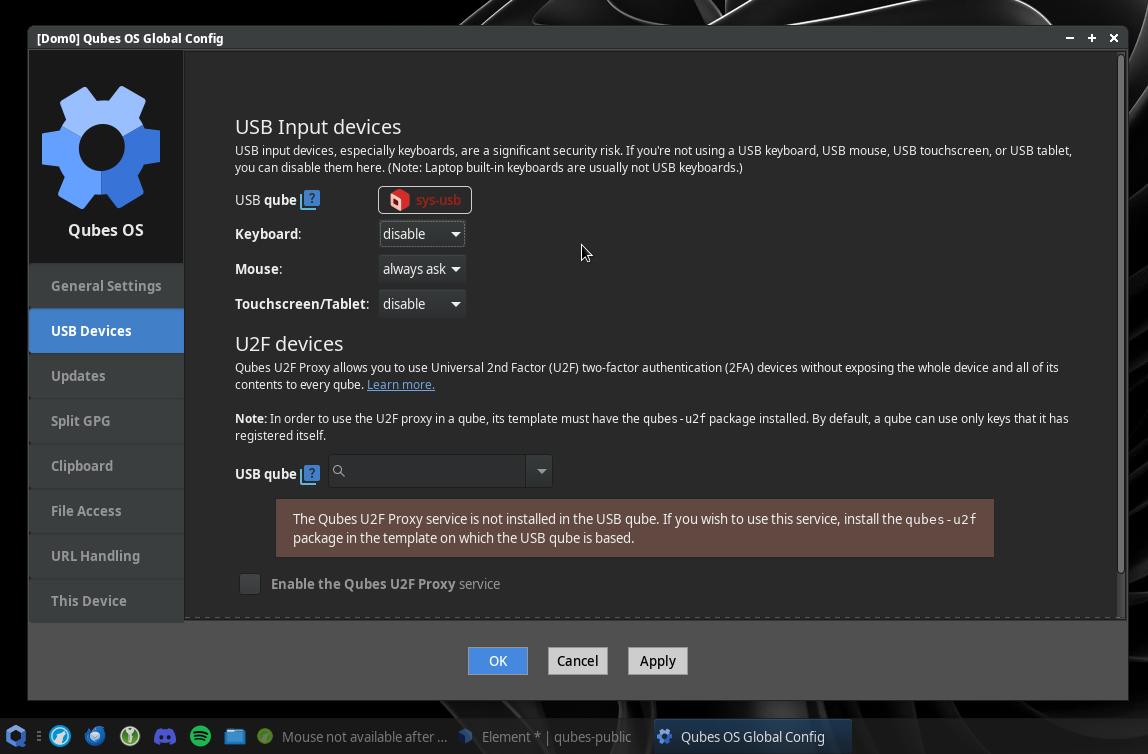

so i got to the setting and it was on “always ask” but it still did not give me the popup window after logging in. so i changed the setting to “enable” and the mouse began to work instantly. i did a shutdown to see what happens after a new start and the mouse did not work after the shutdown again.
i tried changing the setting between “always ask” and “enbale” again to see if the mouse would begin to work but nothing now, it won’t work.
