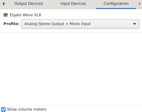

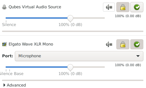

For debugging, could you do the following:
  1. Install pavucontrol in your TemplateVM or an AppVM (for Fedora: sudo dnf install pavucontrol from the terminal)
  2. Attach your microphone to that AppVM as described in previous posts
  3. Launch a terminal in that AppVM and type pavucontrol
  4. Paste screenshots of the “Input Devices” and “Configuration” tabs here

Yes, yes in the qube it is detected an an input device and muting it from the control panel even reflects on my wave xlr, as my way xlr also shows there being working audio but in the volume panel you don’t see the audio.
Okay we have solution! Changing config to mono input fixed it.
