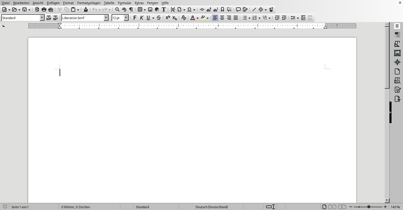

Libreoffice suddenly looks ugly Hello. Since 1 or 2 days libreoffice has changed its appearance and looks like software from the 1980s. I regularly update my Qubes operating system, so I think it has something to do with an update. Has anyone else experienced this?
Background info: After I had issues with libreoffice I was recommended several months ago to do this, which worked very well for a long time.
sudo dnf install libreoffice-kf5
sudo dnf remove libreoffice-x11 libreoffice-gtk3 libreoffice-gtk4
sudo dnf -y update --exclude=libreoffice-x11 --exclude=libreoffice-gtk --exclude=libreoffice-gtk2 --exclude=libreoffice-gtk3

No, it is still the fedora template.
When I use libreoffice on a fedora installation (independent of qubes), it still looks great as before.
this is because you switched to libreoffice-kf5 which is a lot more responsive and use a lot less CPU, but it’s absolutely ugly.
Maybe a Qt theme could fix that.
In fact, libreoffice was super unresponsive before I switched to libreoffice-kf 5. The strange thing is that it did not change its appearance immediately after I switched, but only a few months later.
Okay. I will check out what Qt themes are. Thanks.
