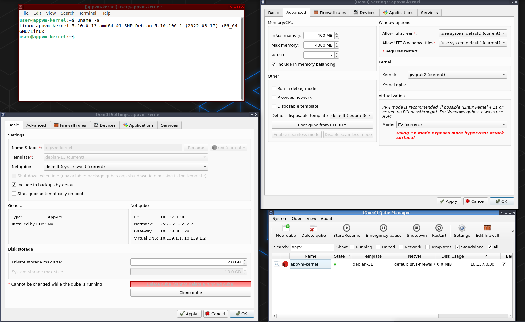

and this options is for PV virtualization mode, however this mode is discouraged for security purposes and i dont want to use it, so, what am i missing? did i made something wrong? does someone had the same problem, how can i fix it?
I have not ever succeeded in booting with custom kernel in appVM other than installing the VM from scratch using a ISO file. I suspect that R4.1 has something different from R4.0 that the documentation has yet unable to cover.
i made a mistake, for running HVM i need to to disable memory balancing and because of it the HVM wasnt running so the procedure is quite simple, just create a standalone debian-11 with no kernel using HVM mode and it will work, and yes, i missed to install it grub2-xen-pvh thank you for the help @marmarek
