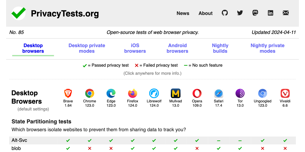

The following study gives a good idea of which browsers to choose
On QubesOS I use Whonix for privacy, then Brave, Librewolf and Mullvad.
Brave is the browser that gives me the most satisfaction, because it lets me access almost all sites without blocking, and videos are smooth on Qubes, which is not the case with Firefox, for example.
