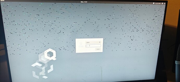

Now I’ve been attempting to get GPU passthrough, I hid my gpu from the Kernal, it was no longer loading amdgpu, and instead pciback. Perfect. Except depending on kernel parameters, lightdm fails to start (I tried sddm and it said something along the lines of failed to get display). On the other chance I get x11 to start, I get this nasty graphics bug which also includes the system freezing
This actually spread to Windows, which made me realize this is likely an integrated graphics bug due to only being able to run Windows off the GPU or in safe mode without the graphics bug and freezing (note: it’s alot worse on qubes)
