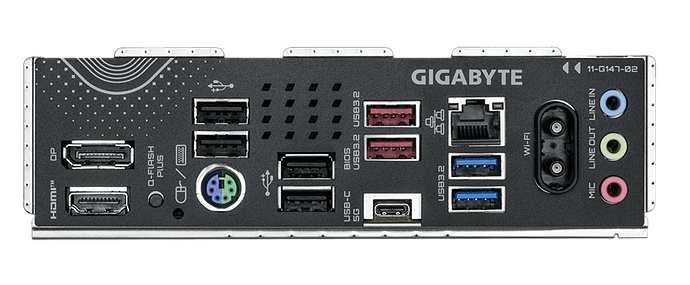

By the way i don’t have a regular network card but a wifi6 antenna I connect at the back to my mainboard

A wild guess from me, would be a motherboard like:
https://www.gigabyte.com/Motherboard/B850-GAMING-WIFI6-rev-1x
where the back looks like:
