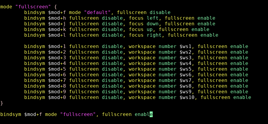

since the upgrade to Qubes 4.3 I am facing issues with I3 window manager not updating windows content in fullscreen.
I have added a custom “mode” to my I3 config that allows to switch windows also when shown in fullscreen. This is the code:
It worked great with 4.2, window switches were flawless. Now with 4.3 I have the issue that when switching windows (especially stacked ones up/down) the app windows often are stuck (not redrawn) and I cannot interact. Moving left and then back to that window mostly solves the problem.
I would like to know if this is something other people are also facing? For me it is a crucial issue as I have worked like that for almost a year and it is very convenient.
Thanks!
