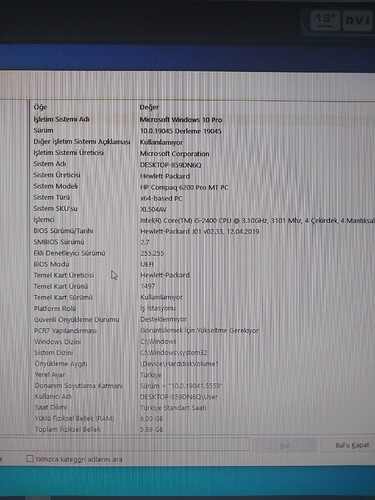

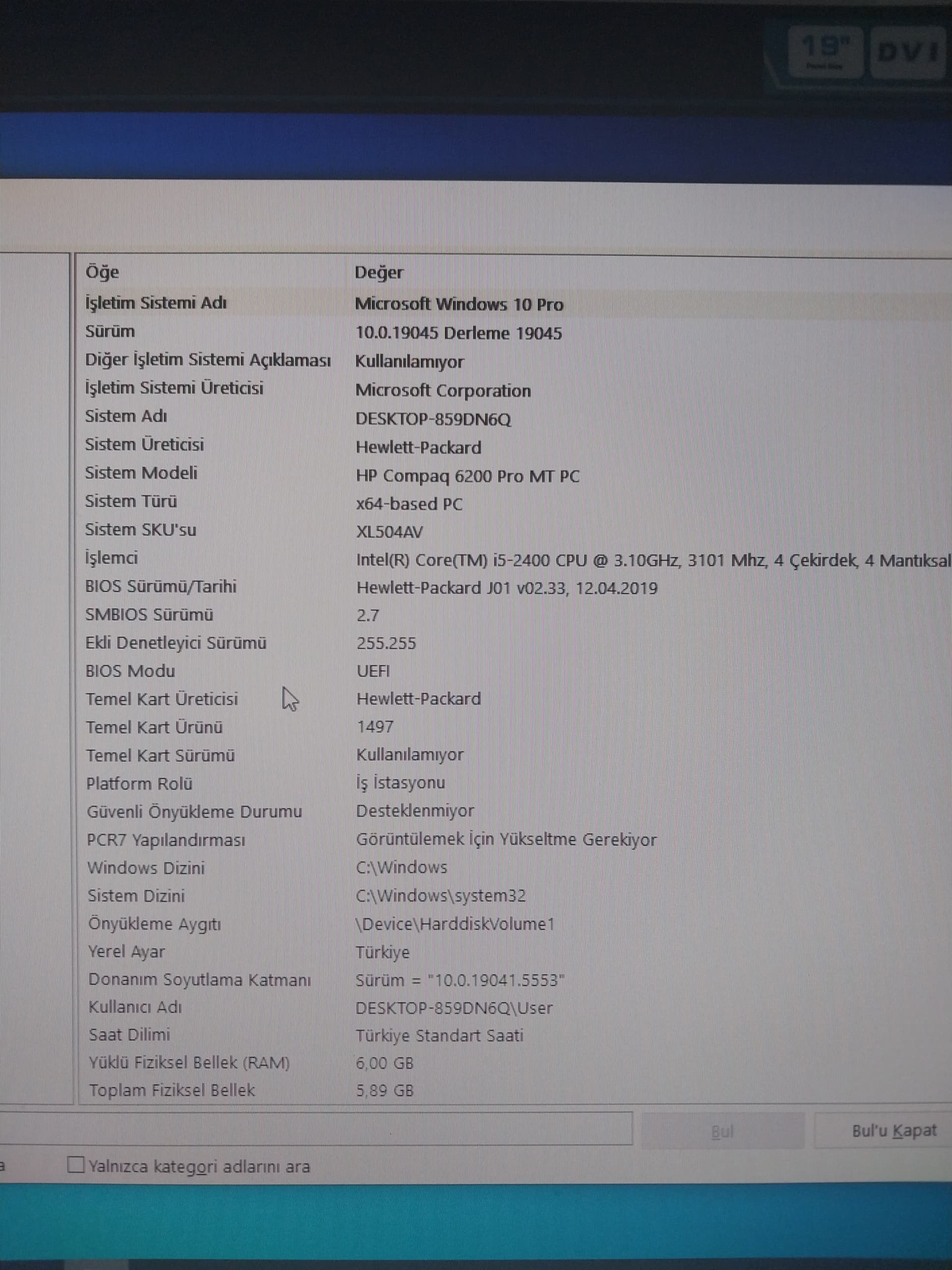

I need HELP - grub shows black screen
I just wanted to install qubes os to my computer but when i boot it from grub its show me a black screen please i need help
Its showing grub but when i select the install it show me a black screen please i really want to install qubes my processor also support virt-tech
Is there anybody can help me

It looks like your computer has only 6Gb memory. I think this can work, but I never tried so little. Maybe other people here can confirm?
