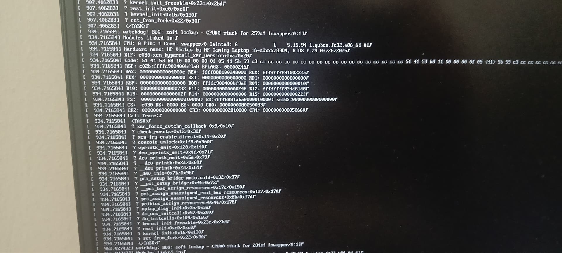

I did, and its in loop on this process.

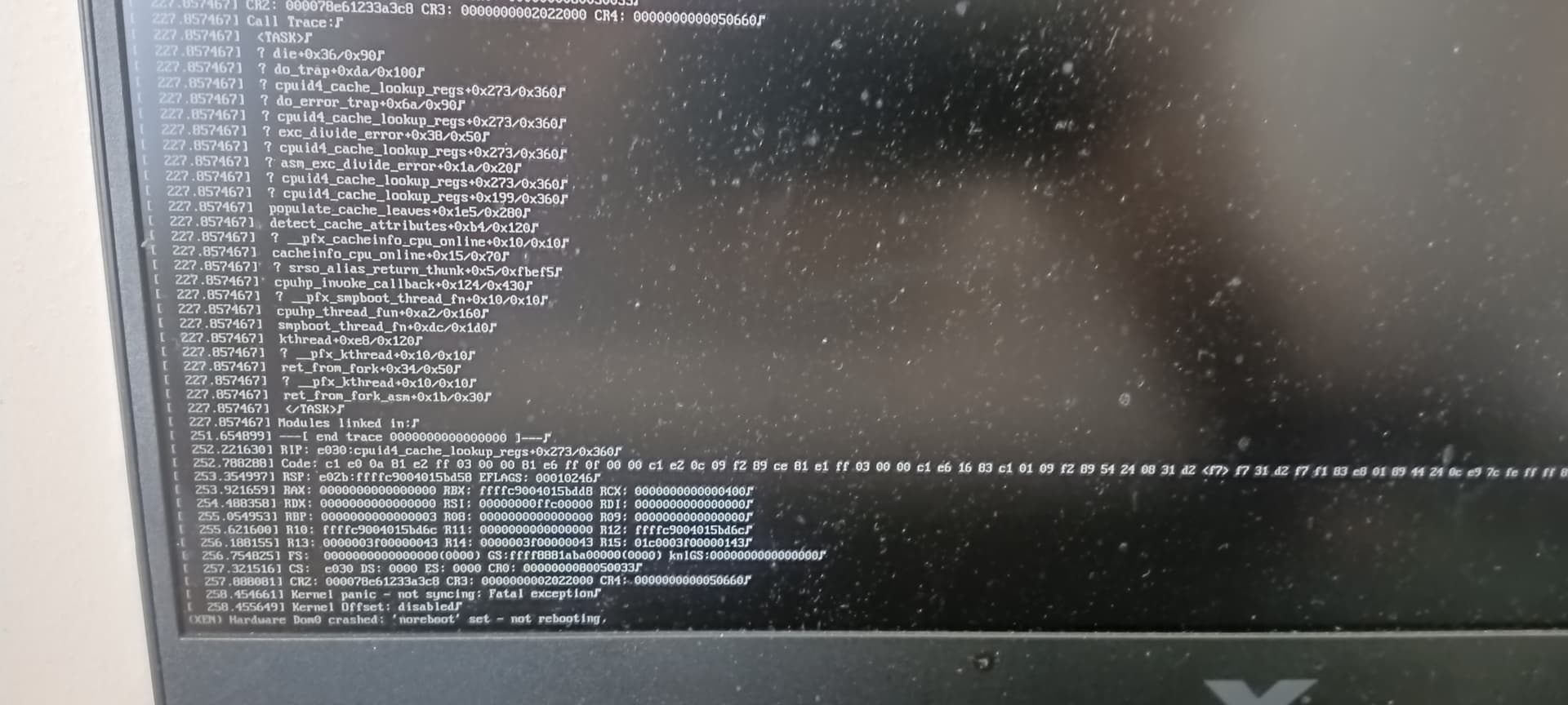

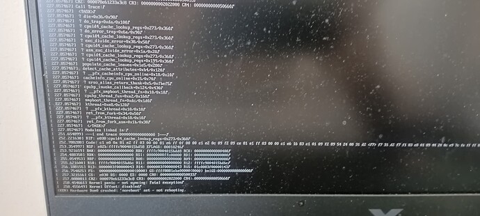

I booted the 4.3 iso but i got this. I’ll lose my mind, I’m trying to install qubes about 5 days.
