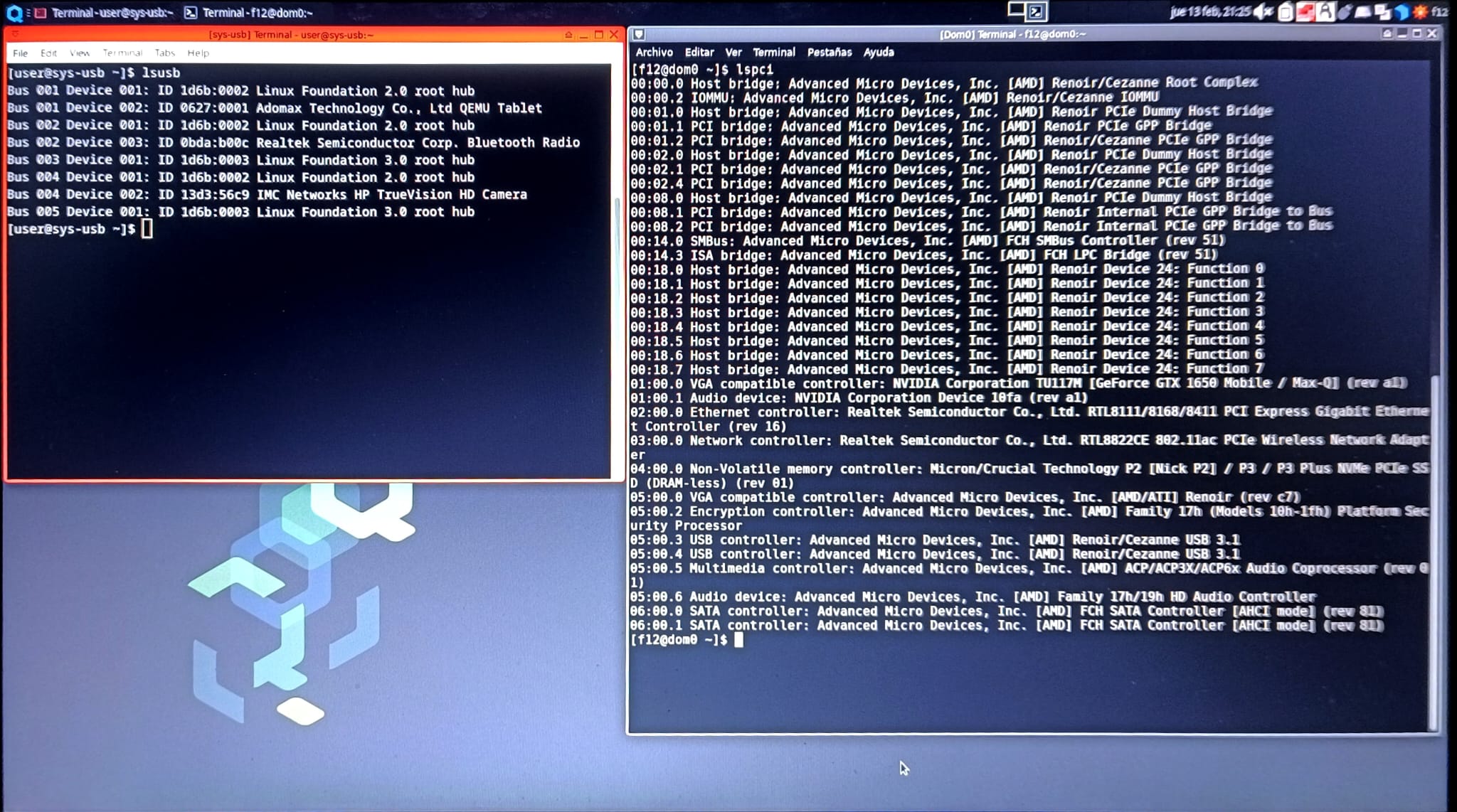

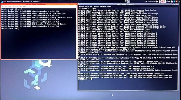

Could you please look at the output of lspci in dom0 and lsusb in sys-usb to identify the vendor and model of the touchpad?

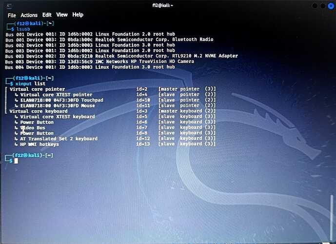

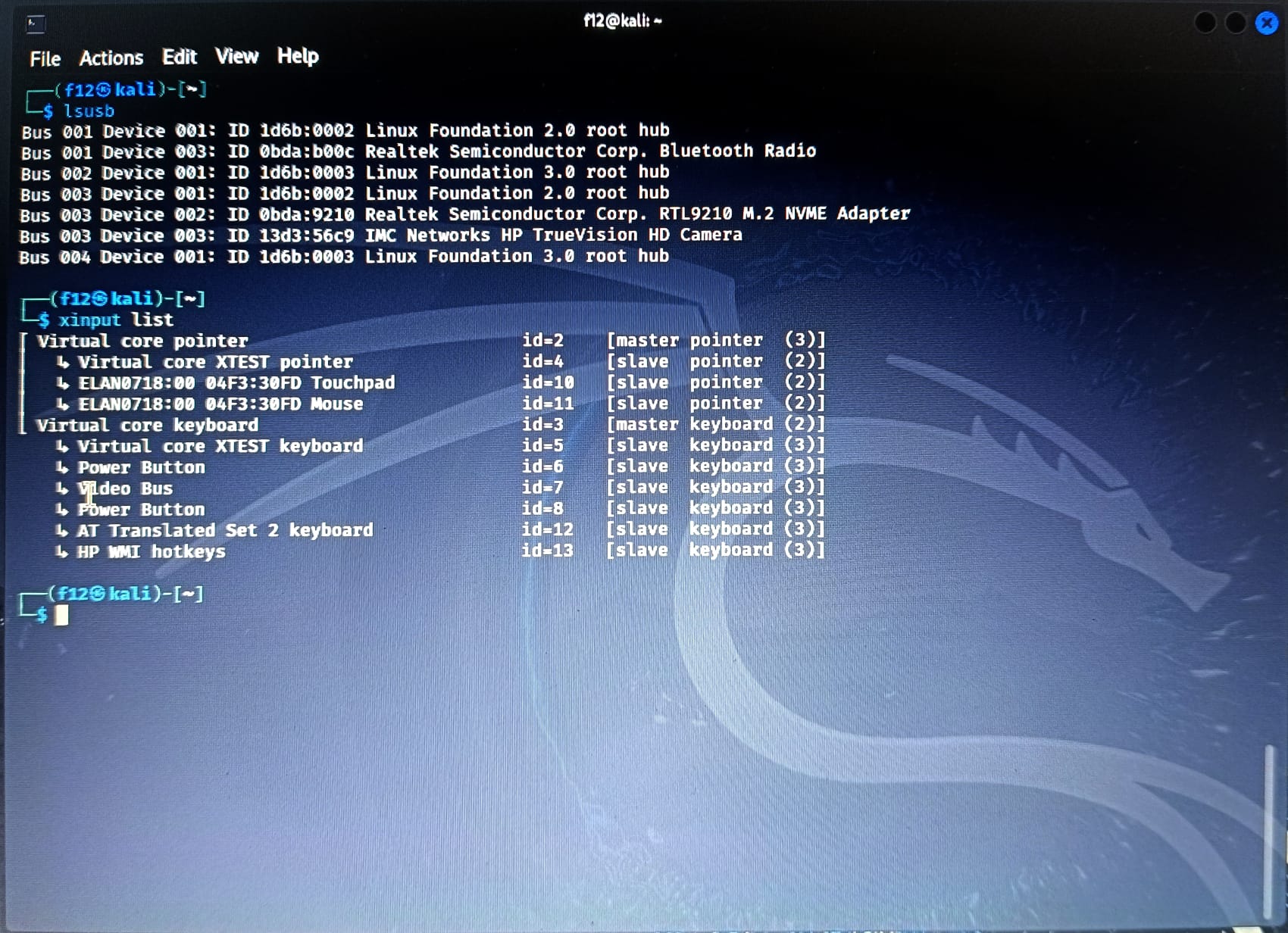

So, I know that the touchpad is called ELAN0718, and qubes dont take it.
Attached pictures about recognition of devices in:
Qubes:
Kali:
