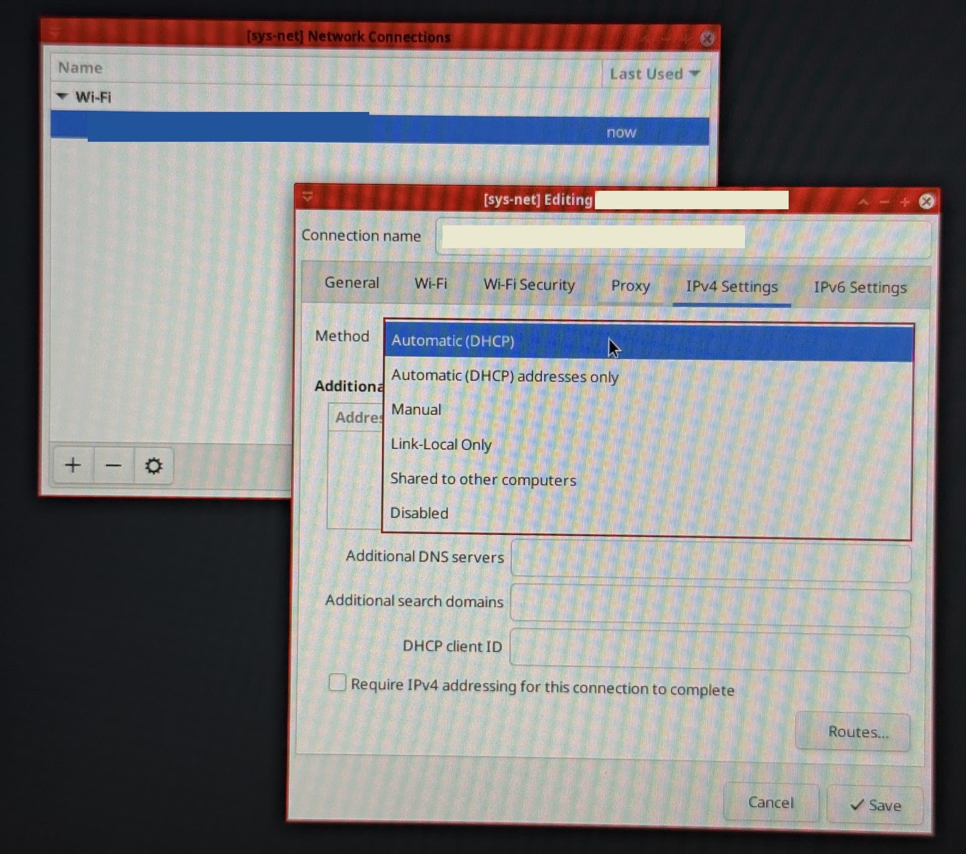

I would generally recommend setting a static DHCP lease in your router, but if you need to set up a static IP address on the Qubes side, you can do so by accessing the network properties in sys-net.

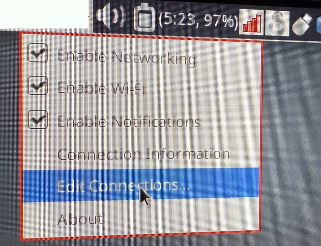

Assuming you’re on a laptop and at least have wifi hardware installed, you can right click on the sys-net widget in the toolbar, “Edit Connections” and then you can add a new or edit an existing connection, under IPv4.

The problem was solved using the Network applet in the tray.
The problem was that when entering the address 192.168.1.50, mask and gateway, it was impossible to enter dots, only commas were entered.
After the reboot, it became possible to enter dots, and the problem with the settings was solved.
