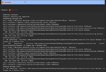

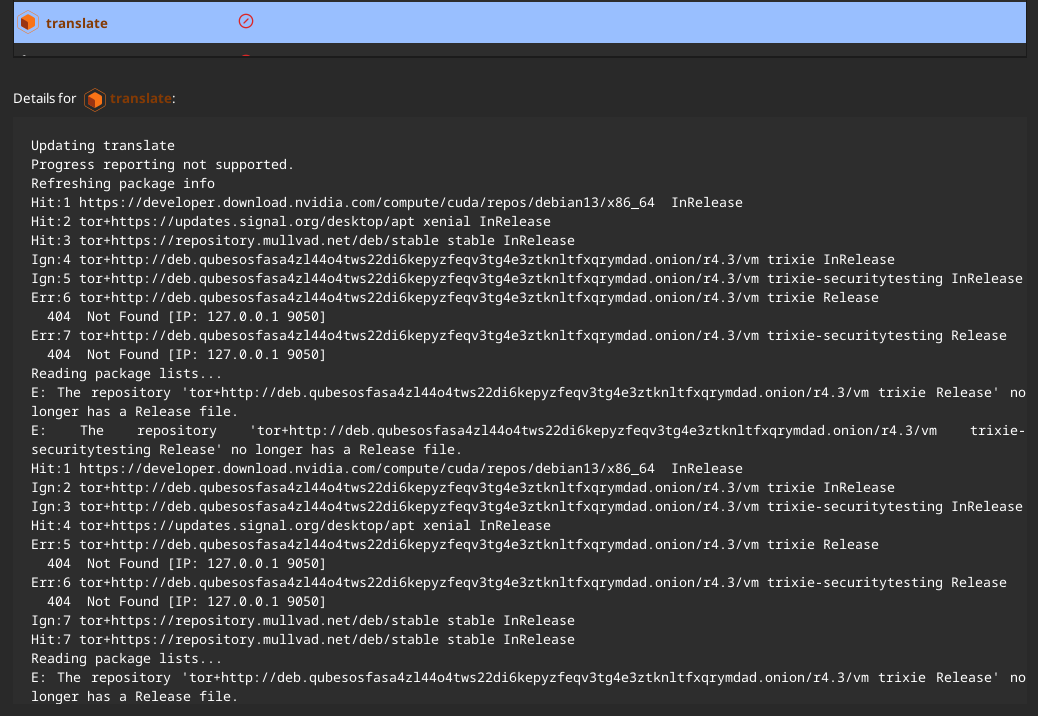

Seemingly I’m really bad at communicating my problems. I try will try to speak in screenshots.

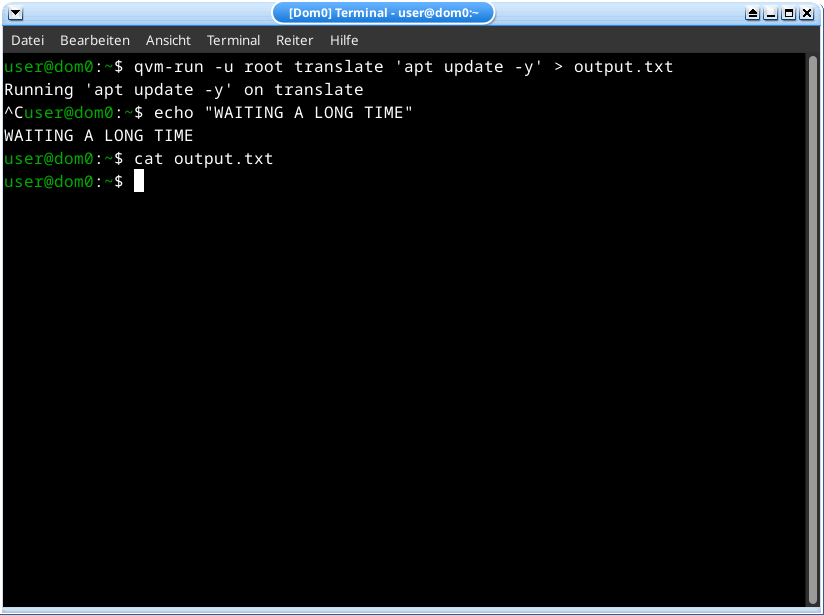

  1. So qvm-console-dispvm is not an option yet but those work with every other qube, I need to install qubes-core-agent-passwordless-root first. As I don’t have access to the qubes gui, I tried qvm-run. But nothing happens.
Independent of the usage with/out --pass-io, the command, outputting.

If you want to increase your chances of getting an answer from at least one of our helpful members, avoid screenshots without a text alternative. Here, copy-pasting from dom0 is better than an image.
I still don’t get why you can’t use a management console. Could you try to run qvm-run with --no-gui?
What is the output of qvm-console-dispvm?
Feel hugged, thank you! --no-gui does it!
