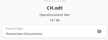

Thanks so much! Running in terminal is super helpful as it shows explanations as to why things arent working⦠Made much progress however, I get a new error⦠i tried ā~/Documentsā and then i tried āhome/user/Documents/CH.odtā because this is how it shows in nautilus properties for the file. But for some strange reason, i get āhome/user/home/userā But i only entered it once.

Specify the absolute path:
~/Documents/CH.odt
or
/home/user/Documents/CH.odt
Donāt remove / at the beginning or youāll be using path to the file relative to the current ditectory (/home/user by default) instead of the absolute path.
The only way it works is if I remove / ⦠Nothing else works, i tried ~/Documents/CH.odt, and i tried /home/user/Documents/CH.odt (which for some reason outputs home/user/home/user/Documents/CH.odt)⦠The only way it works on this computer is qvm-run Documents/CH.odt Maybe i screwed something up and now it doenst work like its supposed to, but at least it works now and all is well!.. Thank You! YeeeeeHawl!
