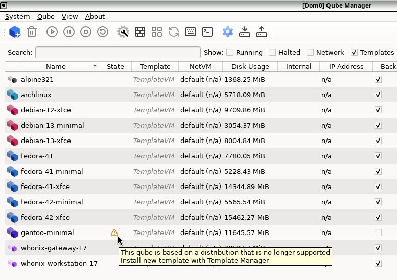

Yellow triangle in Qube Manager? Like the screenshot below?
This means that the template is EOL (End-of-life). There should be some instructions from Mullvad on how to download updated templates or update the existing template in-place

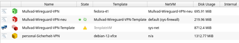

Is this right? You have a qube called Mullvad-Wireguard-VPN which is
based on a template - you have change the template to fedora-41.
You have a separate template called Mullvad-Wireguard-VPN-Template -
it is this that shows the yellow triangle.
What do you see if you point to the triangle and hover on it?

Here is the image of my VPNs
personal-security-VPN, is just a storage place of VPN info, files and so on.
Can I now
fedora-40
fedora-40-minimal
fedora-40-xce
delete / remove?
As some users like @unman can’t see the image, it’s better to describe it.
So the warning icon (yellow triangle) is displayed as the status of a qube called Mullvad-Wireguard-VPN-Template which is a TemplateVM with sys-net as the NetVM.
Putting your cursor on the triangle doesn’t show a tooltip like the one in @alimirjamali’s screenshot? If so, could you write it down here?
Could you check the exact version of Fedora used in Mullvad-Wireguard-VPN-Template?
This qube based on a distribution that is no longer supported Install new template with Template Manager
