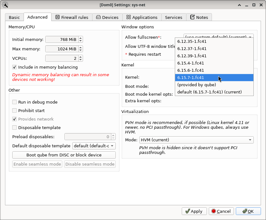

Before proceeding with trying to compile the DKMS driver from source, could you please try to install the following in dom0 (if you could connect via Ethernet):
sudo qubes-dom0-update kernel-latest-qubes-vm
And in sys-net config, select one of the 6.15 kernels in the drop-down list. Like picture below:
Then see if detects your hardware.
