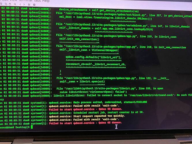

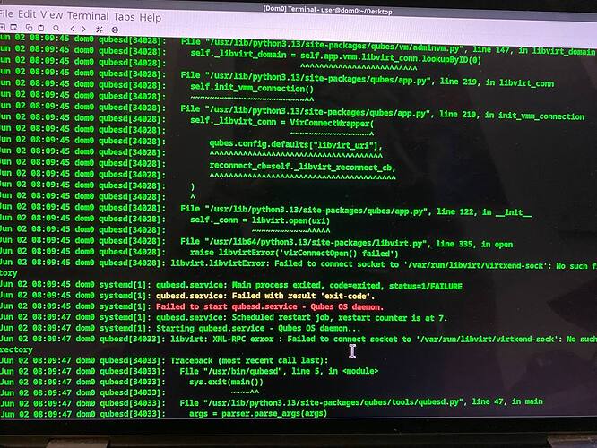

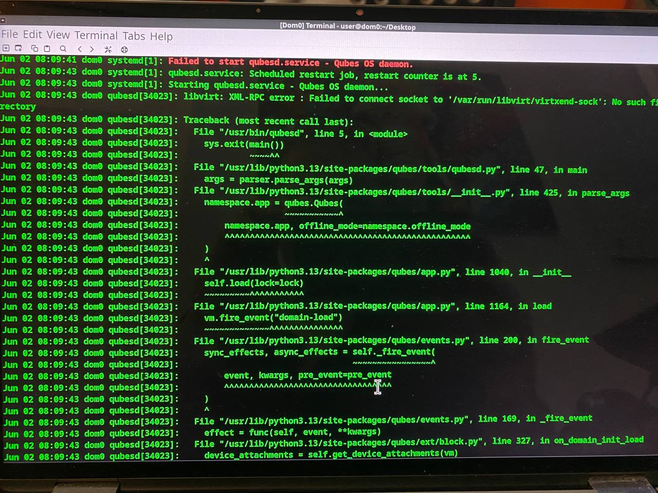

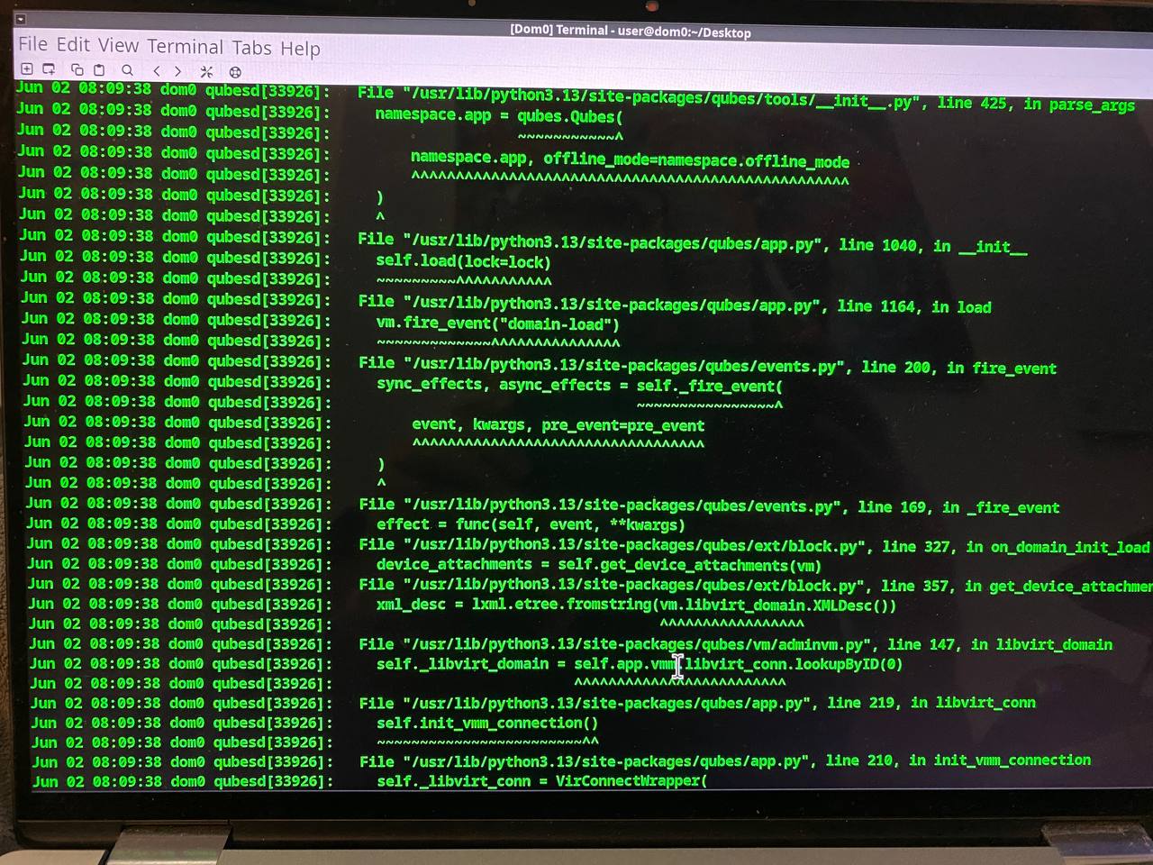

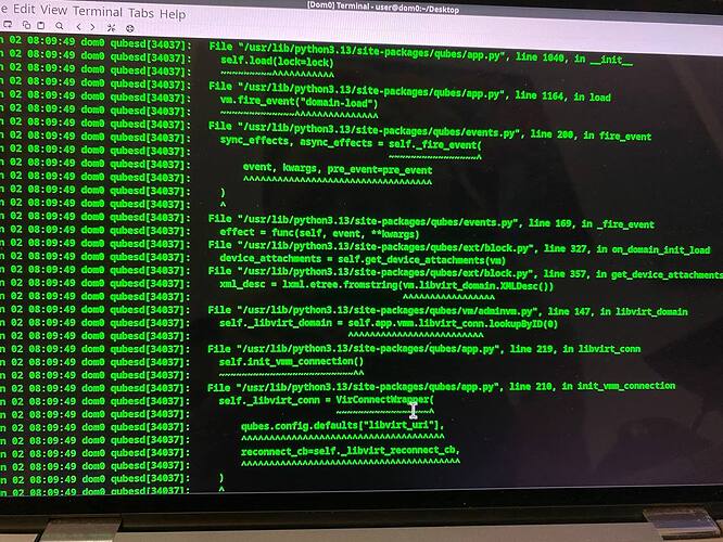

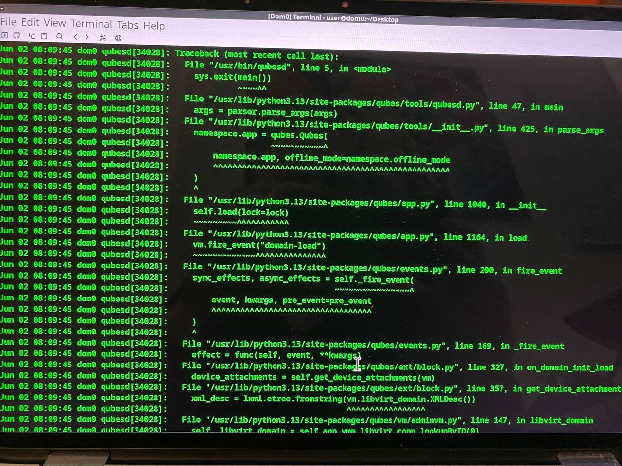

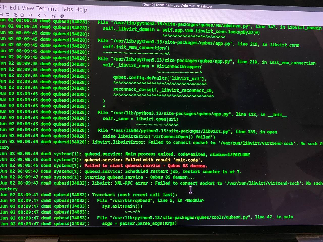

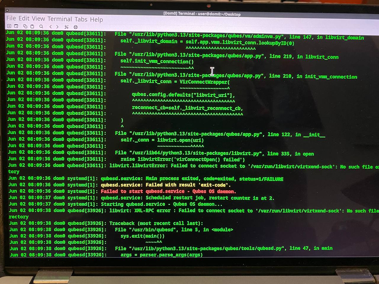

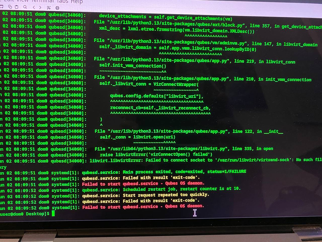

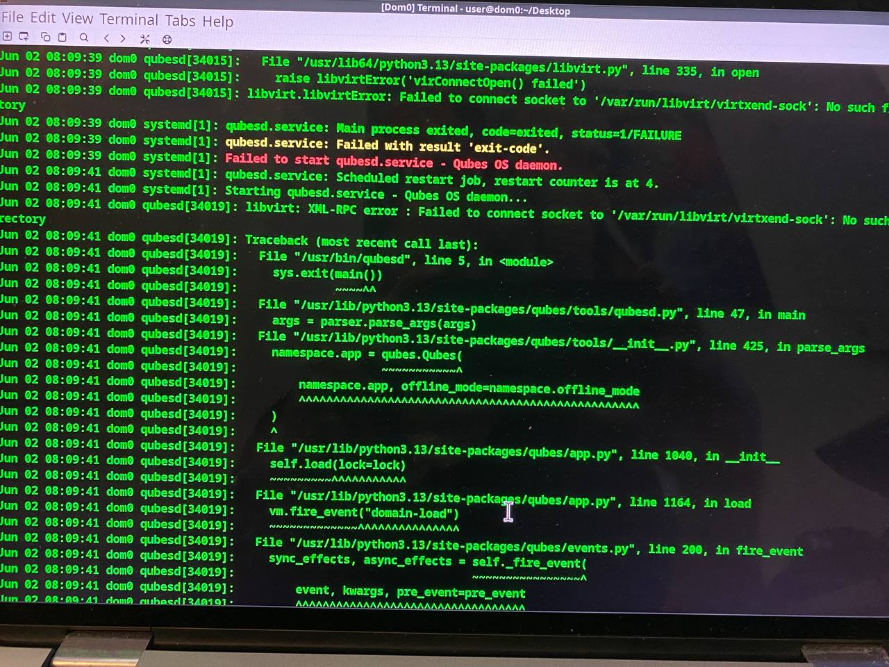

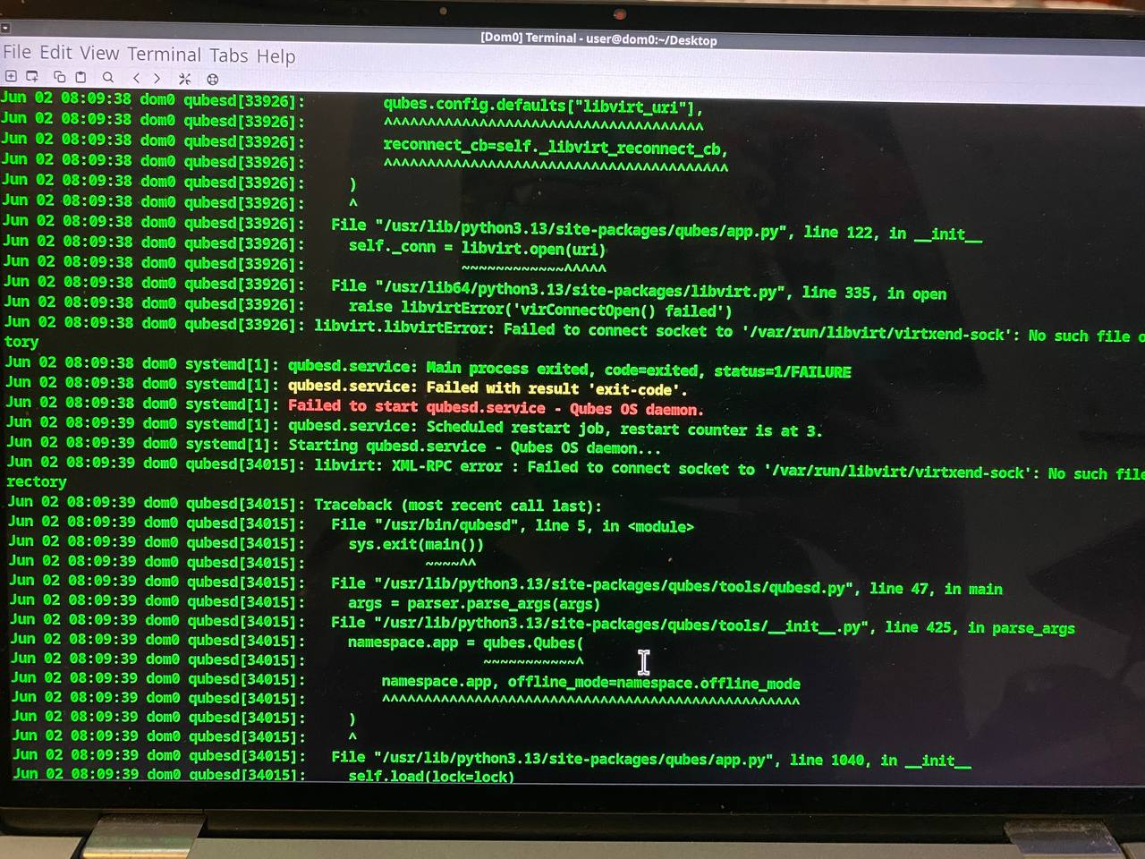

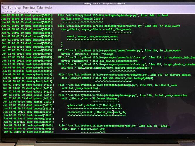

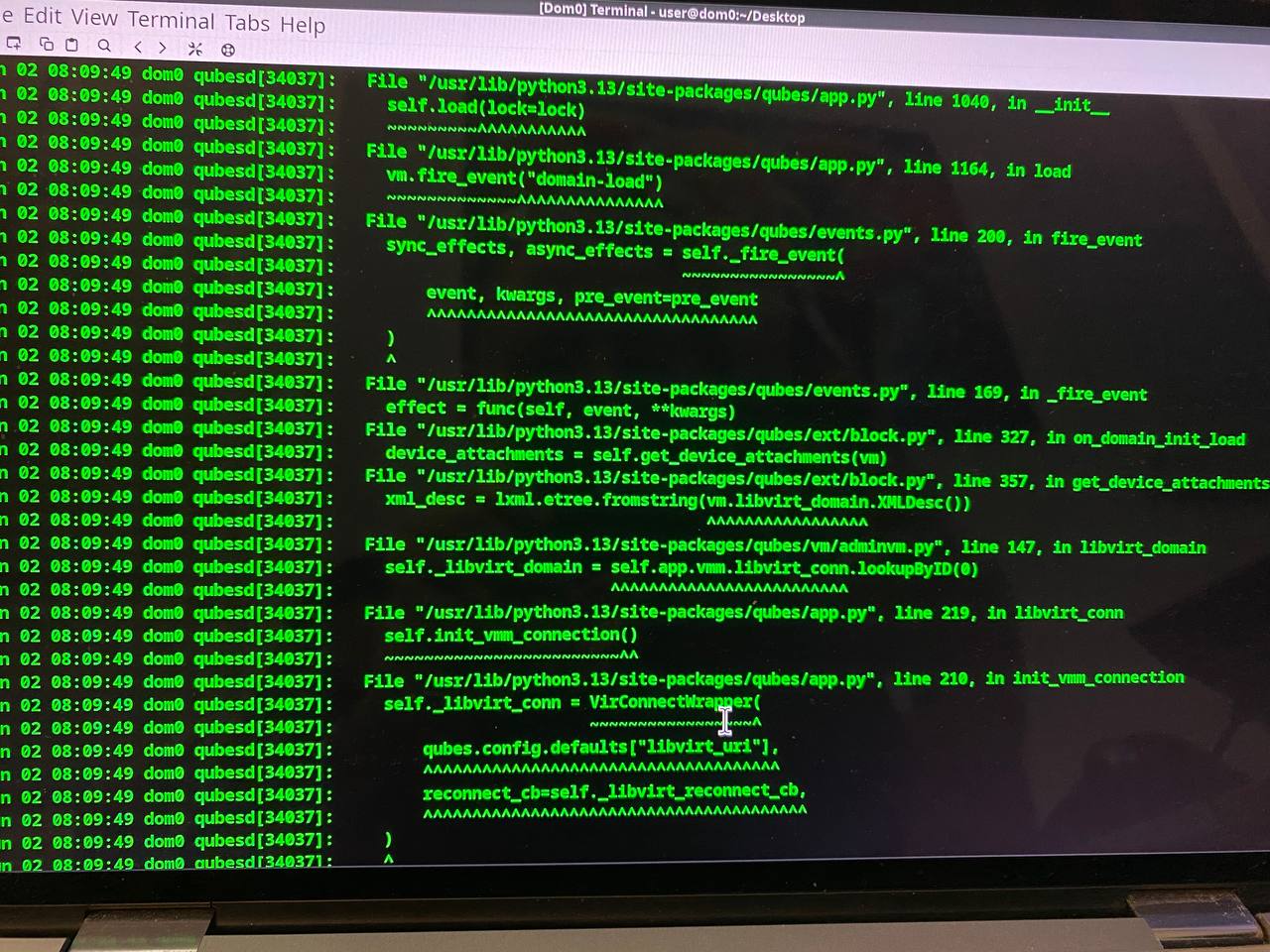

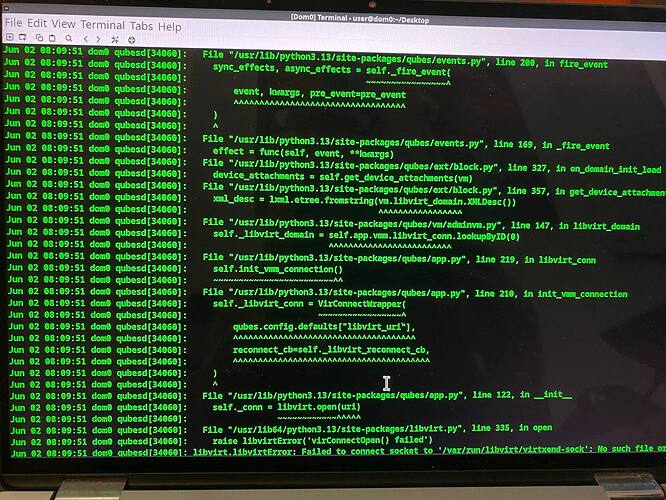

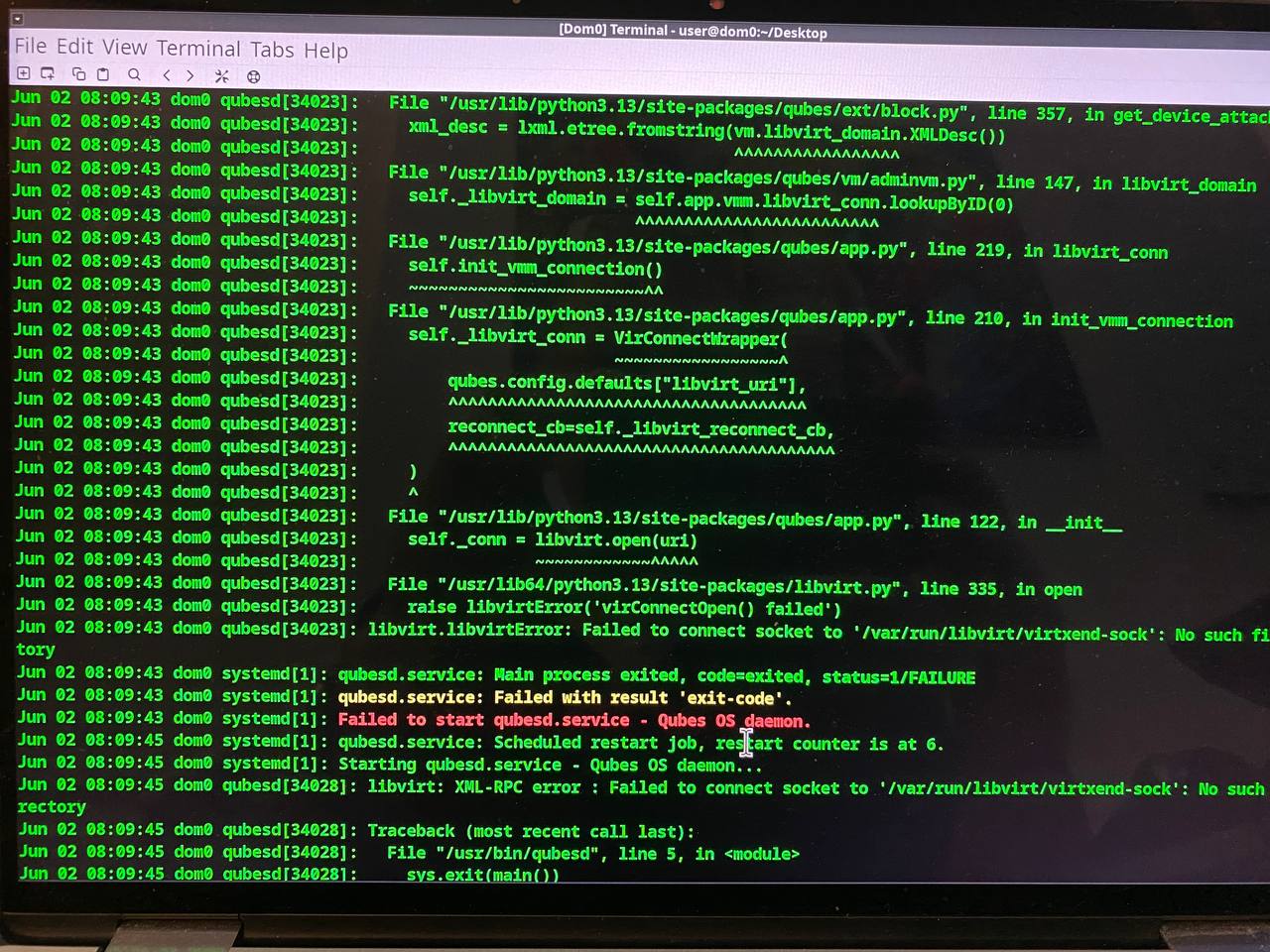

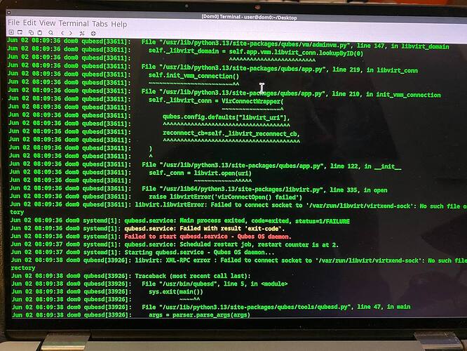

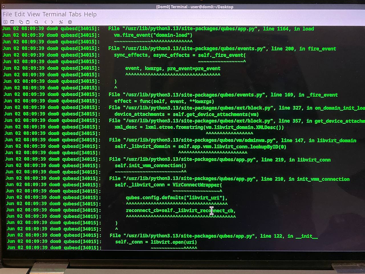

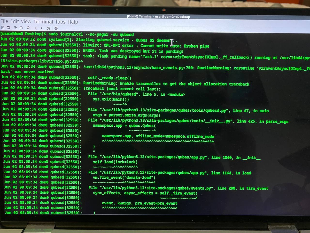

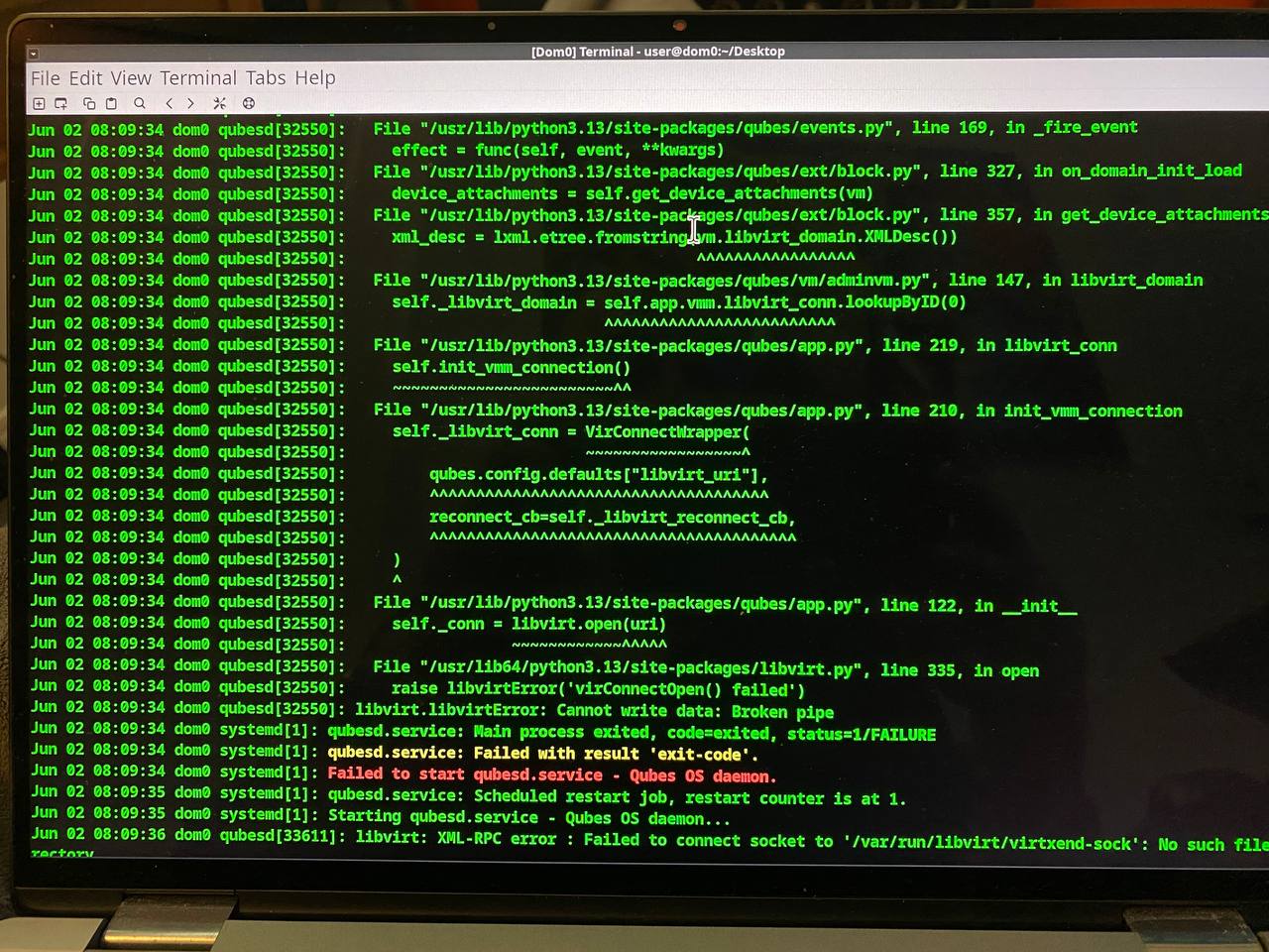

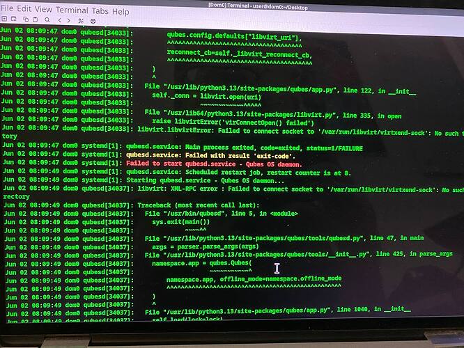

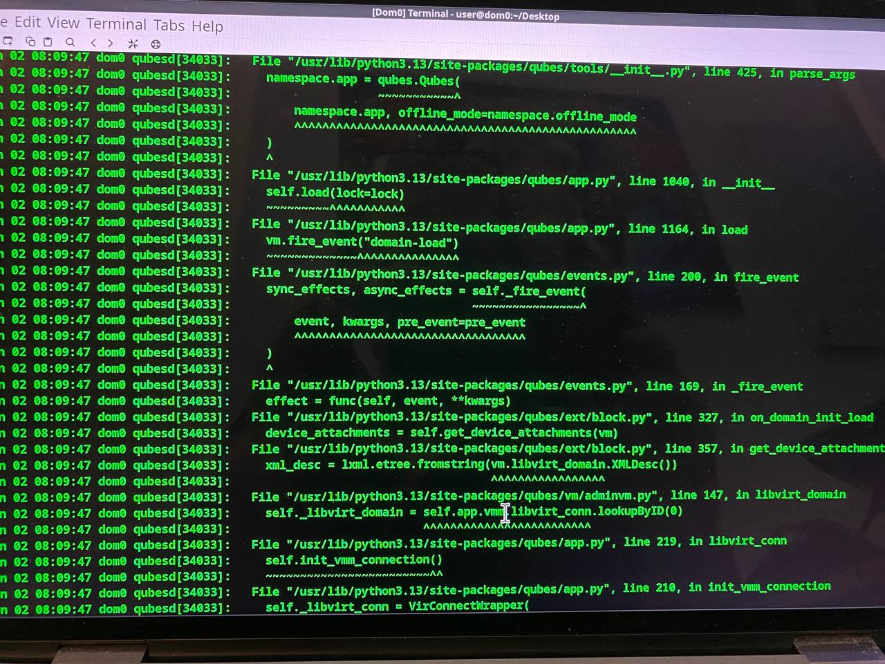

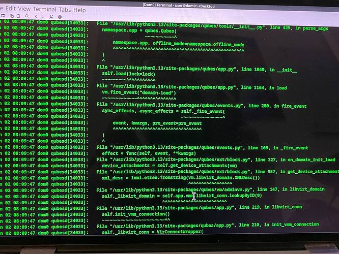

Hi. I think is missing the end of the traceback. Can you share more of the journal? If qubesd is not starting, I don’t think there is an easy way to extract information from any qube except by mounting the volumes to another OS. So, I think it’s fine for you to provide images. Maximize the terminal window to fit more logs into less photos, and share some photos.
sudo journalctl --no-pager -eu qubesd
Then you can scroll the window to sell all the recent logs.

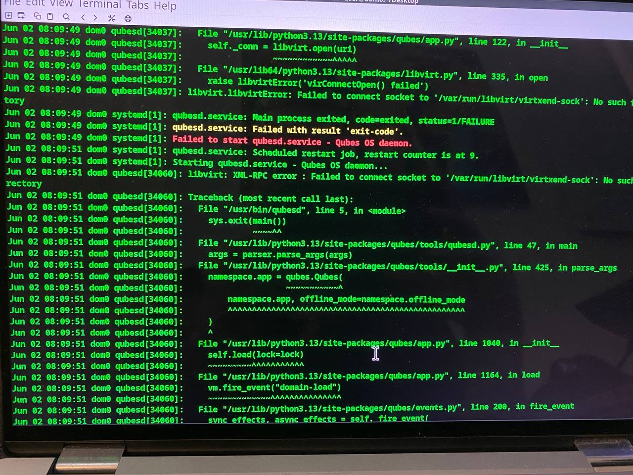

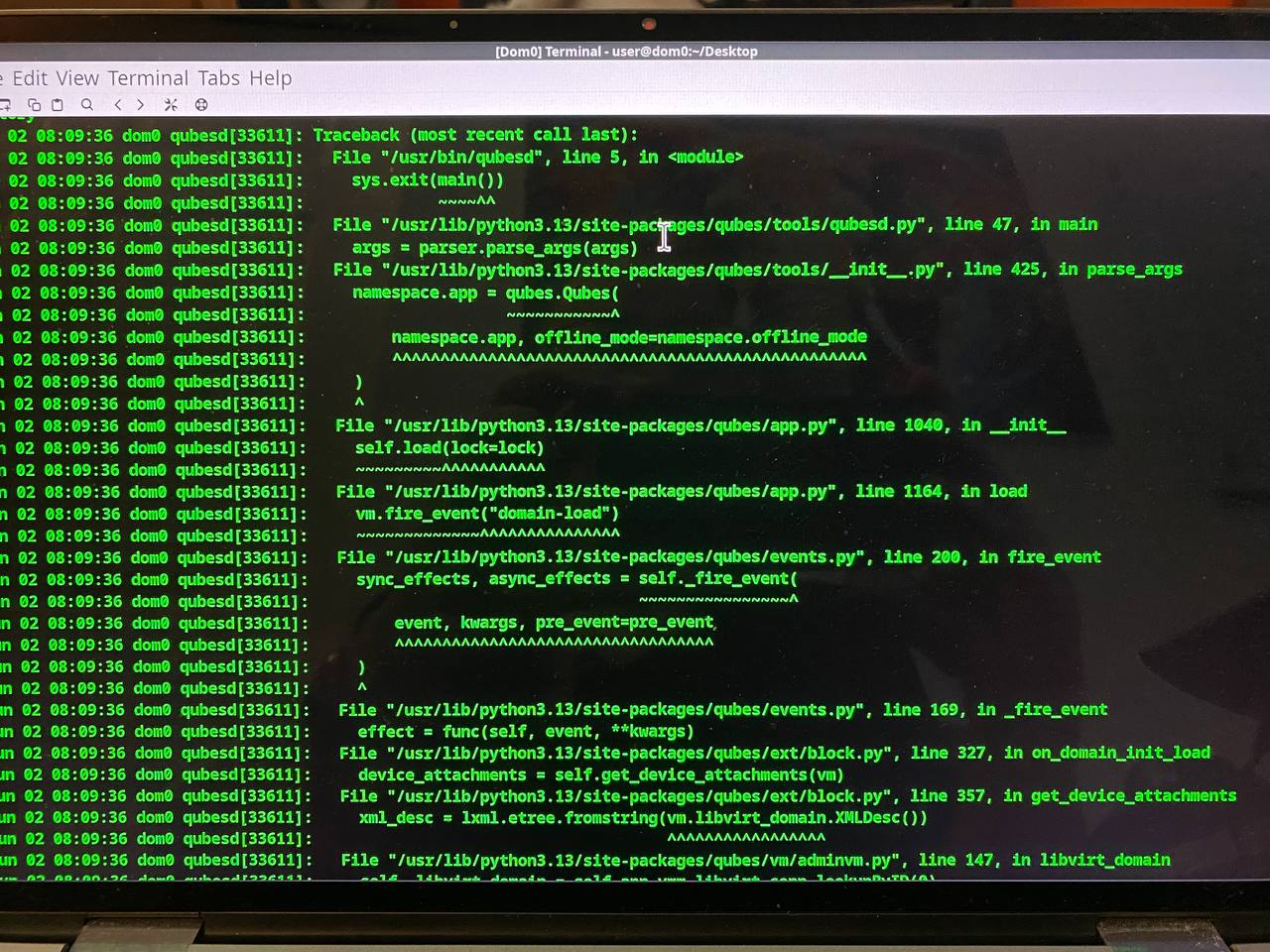

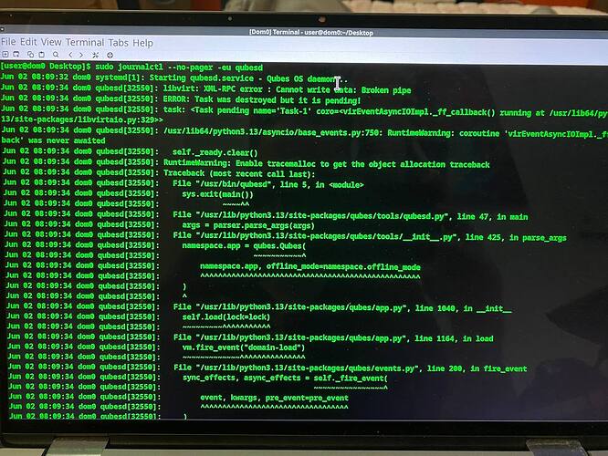

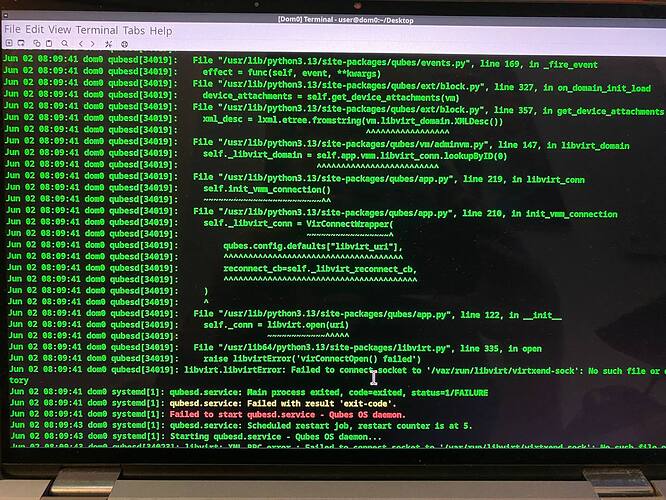

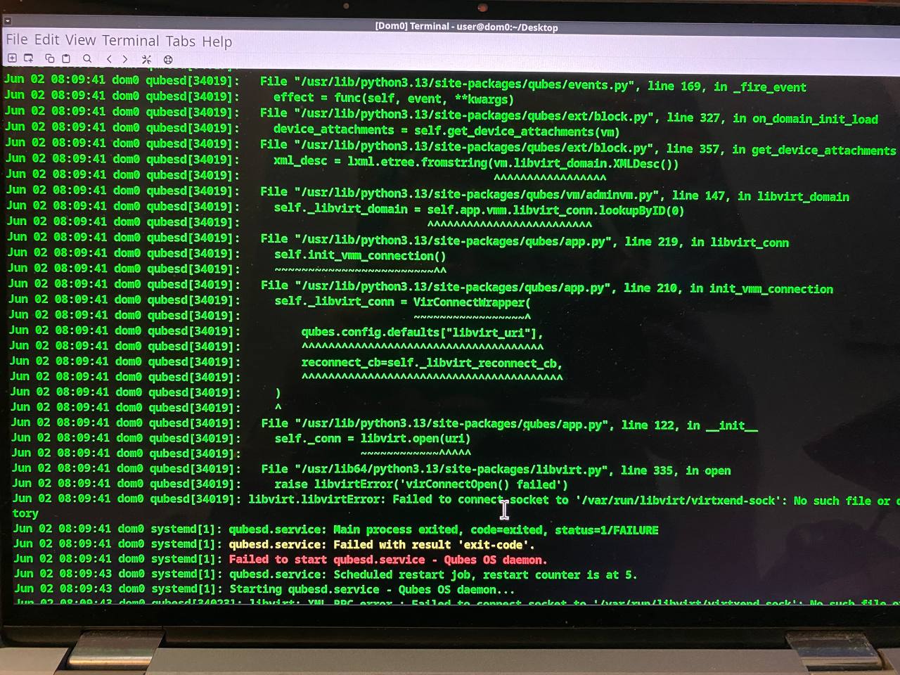

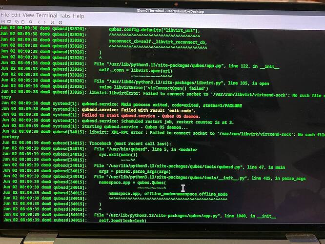

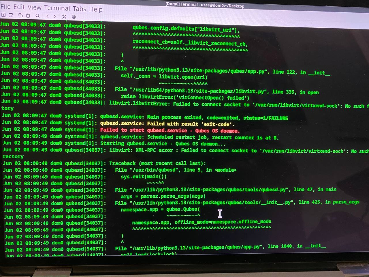

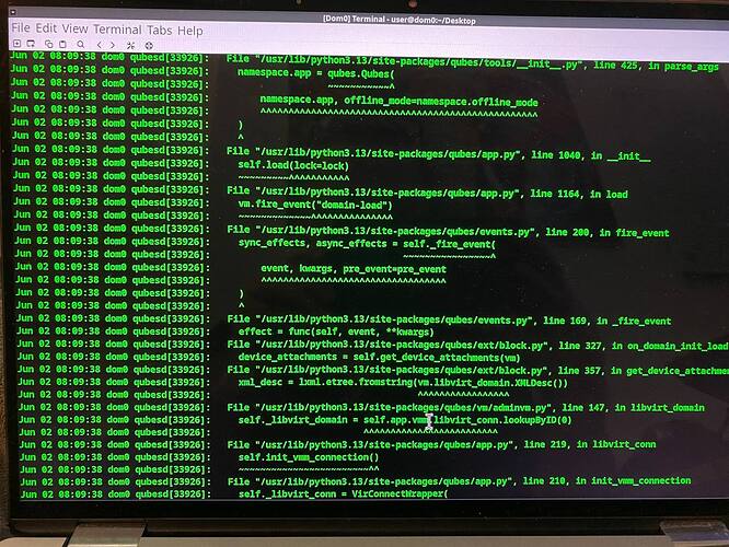

Thanks for replying. As requested, here are photos when I run
To assist in seeing them in order, I’ve numbered 001 - 019
Since I am only allowed to upload 5 at a time, here photos 001 - 005:
Photos 006 - 010:
Photos 011 - 015
and finally, photos 16 - 19

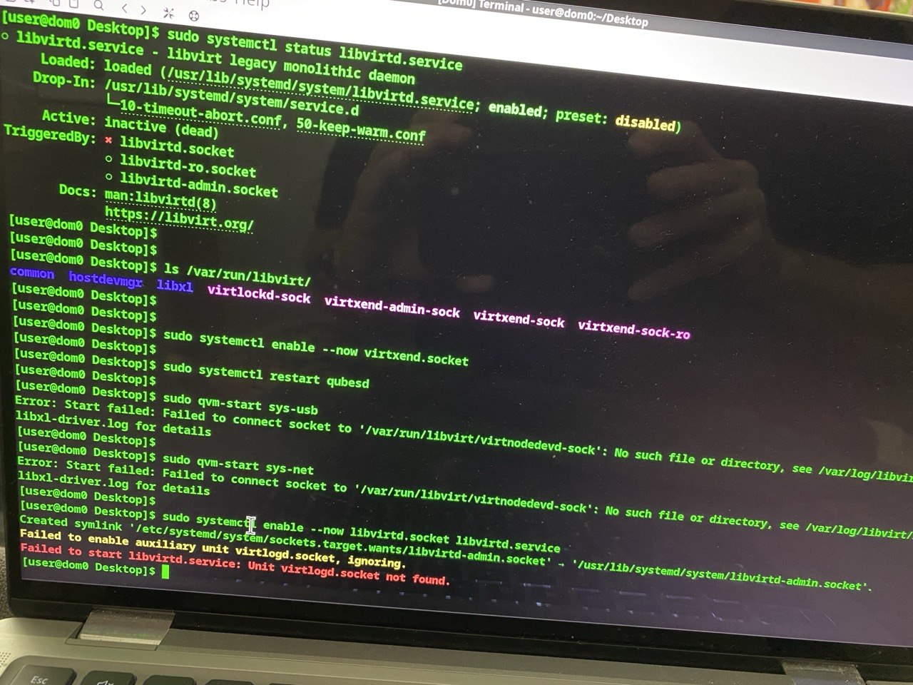

For me this line sticks out:
Photo_2026-06-02_17-03-07
great, any suggestions on how I fix it?

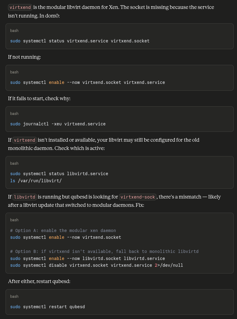

The claude output seems relative competent to get a deeper look into it. Would you mind obeying and sharing what you find out?
Thanks for the claude suggestions.

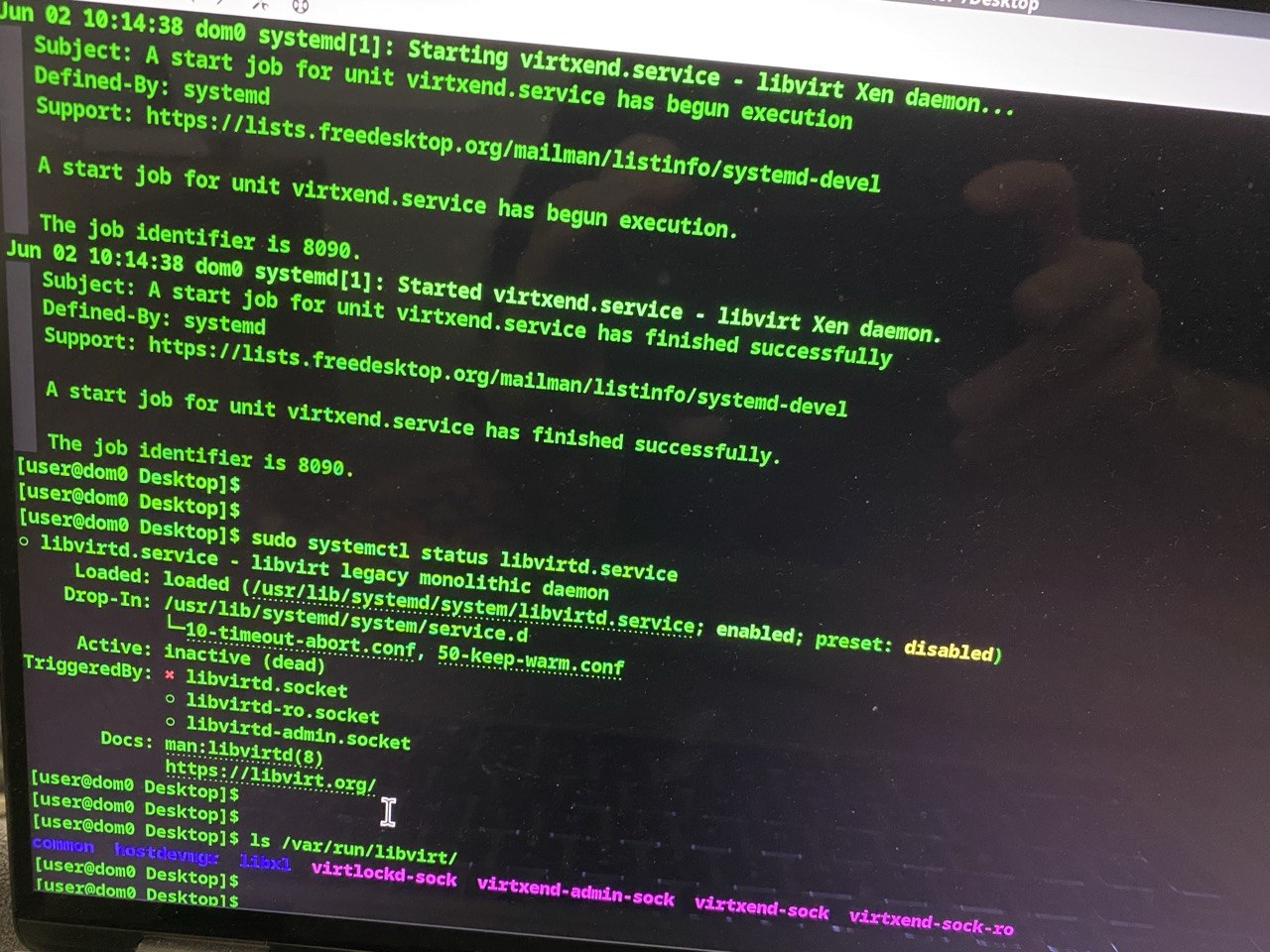

Here are the results:

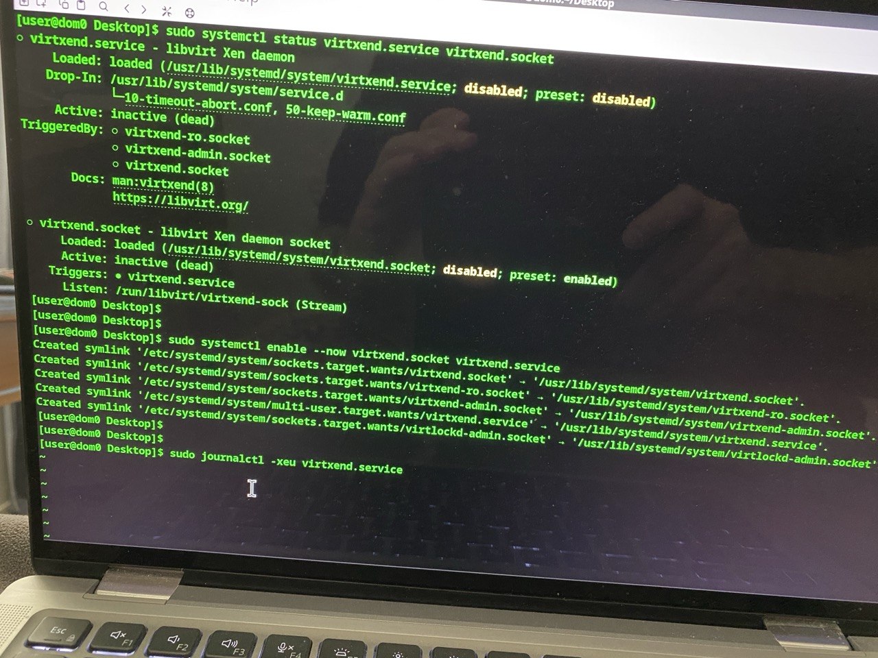

Maybe try to start and enable this services:
- virtxend.socket
- virtxend-ro.socket
- virtxend-admin.socket
- virtnodedevd.socket
- virtnodedevd-ro.socket
- virtnodedevd-admin.socket

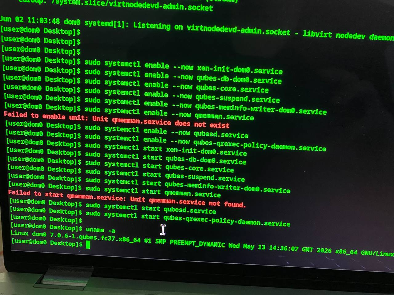

I started and enabled all of the services that you listed without any errors.
When I checked their status, all of them show that they are loaded, enabled and active (listening) (with no errors)
This services should also running:
- xen-init-dom0.service
- qubes-db-dom0.service
- qubes-core.service
- qubes-suspend.service
- qubes-meminfo-writer-dom0.service
- qubes-qmemman.service
- qubesd.service
- qubes-qrexec-policy-daemon.service
What Kernel are you using? uname -a
I’m running 7.0.6-1.qubes.fc37.x86_64
All services okay except qmemman.service returned:
Failed to enable unit: Unit qmemman.service does not exist
Well qubesd is now running according to your screenshot.
And qmemman should be qubes-qmemman.
What happens now if you start a vm?
qmemman should be on 4.2 and 4.3.
