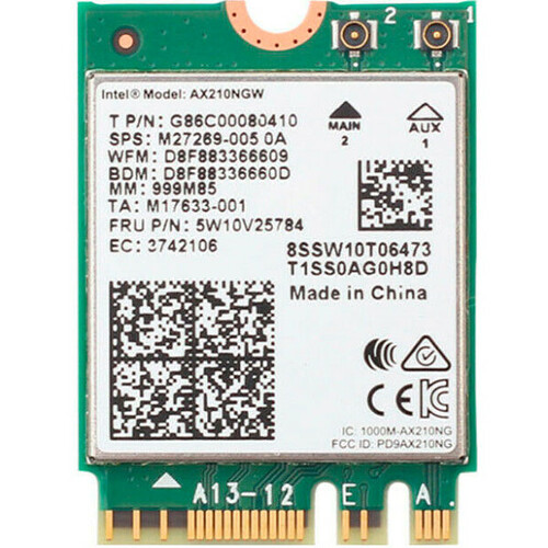

I wonder if a damaged Wi-Fi M.2 card could cause this somehow. Besides being directly connected to PCI it’s also connected to USB (to provide Bluetooth). Maybe try swapping it out, an AX210 is pretty cheap?
That looks like a great shout - I disconnected my AX210 and couldn’t reproduce the problem.

Time to have a look at kernel options for the AX210, see if I can isolate this further.
I might just order a swapout. I’m also trying to work out whether it’s possible/simple to do the same sort of PCI passthrough on Ubuntu without Xen.
If you have some Kapton tape (normal electrical tape is too thick) you could disconnect just the Bluetooth-over-USB part by covering the M.2 card’s USB 2.0 D+ and D- data pins with a narrow and long (to hold on to it when pulling the card out of the socket again) sliver of tape. Disclaimer: I’ve only ever done this with an mPCIe card, M.2 pins are even more annoyingly tiny.
In case you want to try it please double check my shape rotation, but I think they’re the middle two pins on the bottom right corner’s four-pin nub marked “A” in this photo. (No idea if both surrounding GND pins are redundant with the card’s other GND pins and not required for anything besides USB, because covering all four would be a lot easier.)
I’d love to see if this works, but don’t have much confidence working at that scale (it looked okay on screen, but of course the chip’s smaller!) and probably don’t know enough to avoid doing bad things to the circuitry.
I’ve blacklisted the btusb
kernel module in the template backing sys-usb. Looks promising, need to test more.
I haven’t seen the problem since, so marking this as solved. Thanks everyone.
