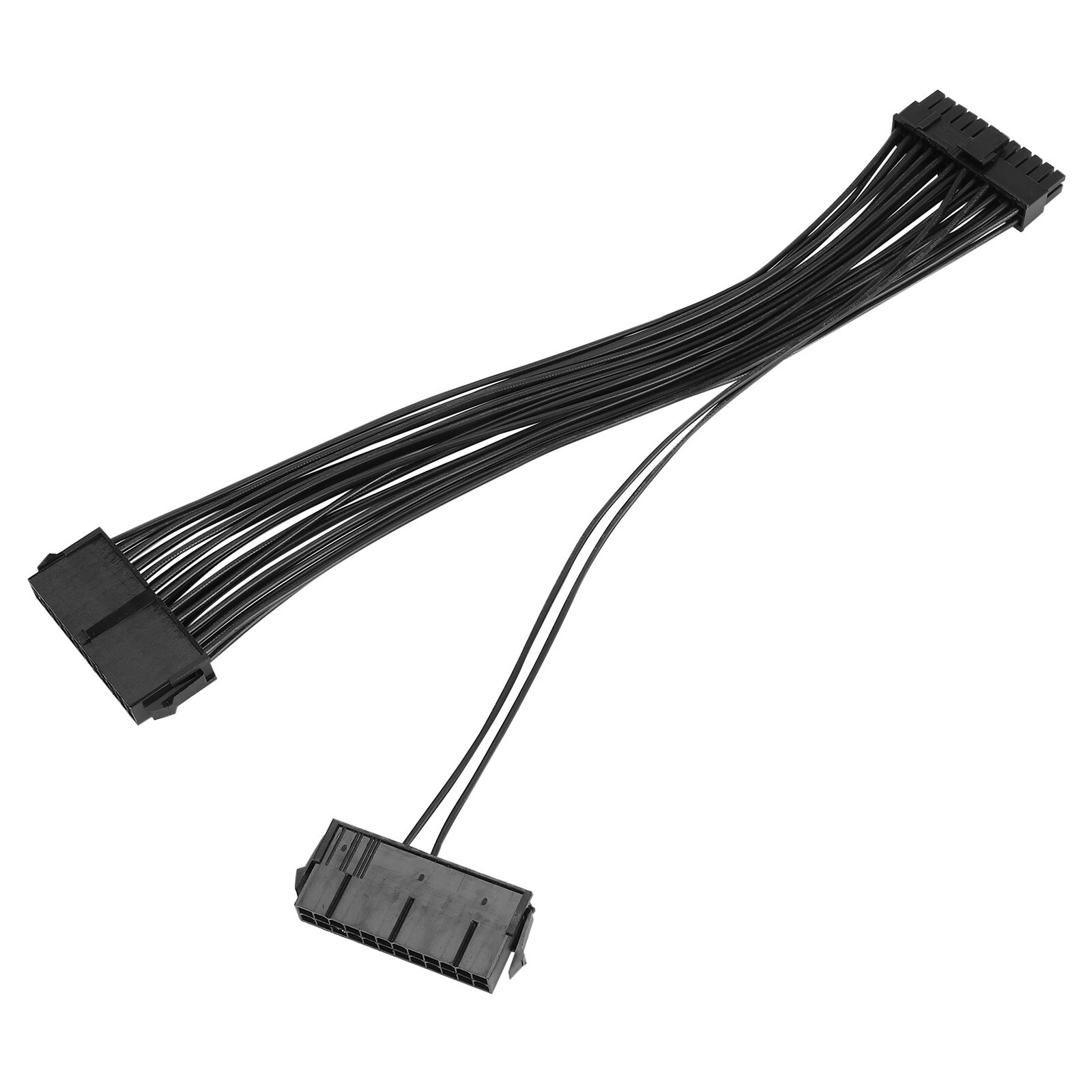

I connected the 2 psu with a cable like this:
So both PSU turn off/on at the same time. I assume this means one ground wire/pin is connected?
And both PSUs are connected to the same power strip.
That cable looks correct - I am guessing it connects from one supply to the other: one position which normally has a black wire, and the position which normally has a green wire.
I haven’t studied the details for modern pc hardware, but from (moderate) experience with general electronics, often it will work, except for when it doesn’t. Some supplies pull to zero output if they get overloaded, and if zero isn’t the same everywhere then the other supply might be pulling in a different direction, possibly via the bus driver chips. Similarly if a component fails…
With hot swappable hardware, it might not give permanent damage (I don’t know this, just guessing) but I wouldn’t risk it, even just to avoid possible data corruption.
