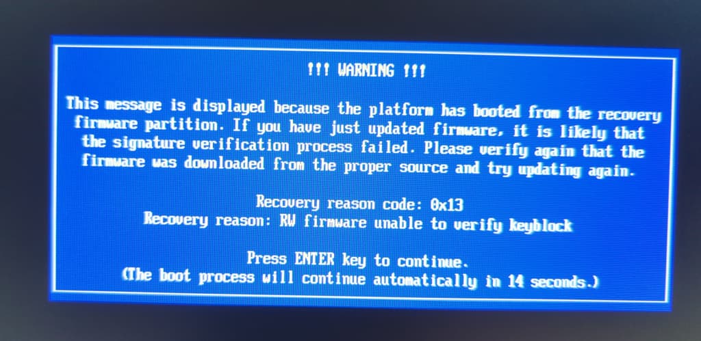

On the Z690 and Z790, Dasharo uses vboot, and you are going to get a warning if the installed firmware isn’t signed with the installed certificate.
The certificate is installed in a read-only firmware region, there is no way to update without physical access to the system.
Here is a screenshot of the vboot warning.
You can use the Dasharo build scripts to build the firmware with you own personal keys, but I believe that the pre-built firmware is signed with 3mdeb keys.

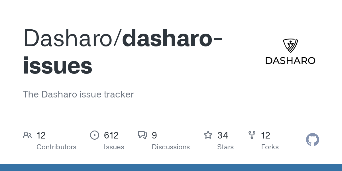

Dasharo has published a security advisory for this issue, somewhat hidden in their github page. The release is still not withdrawn, and NovaCustom has not made a visible blog post about the issue.
