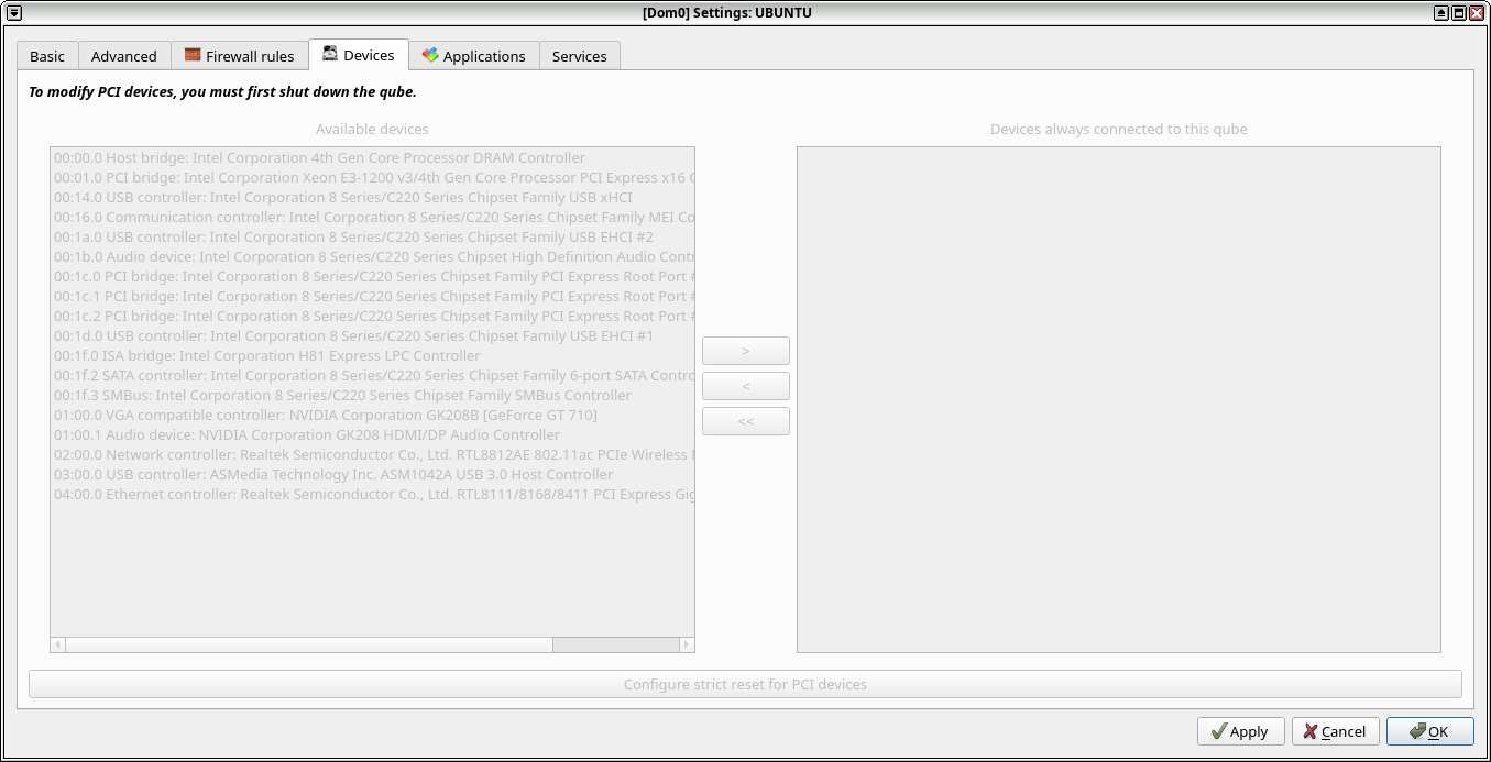

Do I need to enable the devices from “Qube Manager->Setting->Device”?

In the second image I’m in the -Qube manager-setting-device- obviously with the mouse pointed at the VM with UBUNTU.
I didn’t install any particular package. Is it necessary to install any other software package to connect USB and PCI peripherals?
