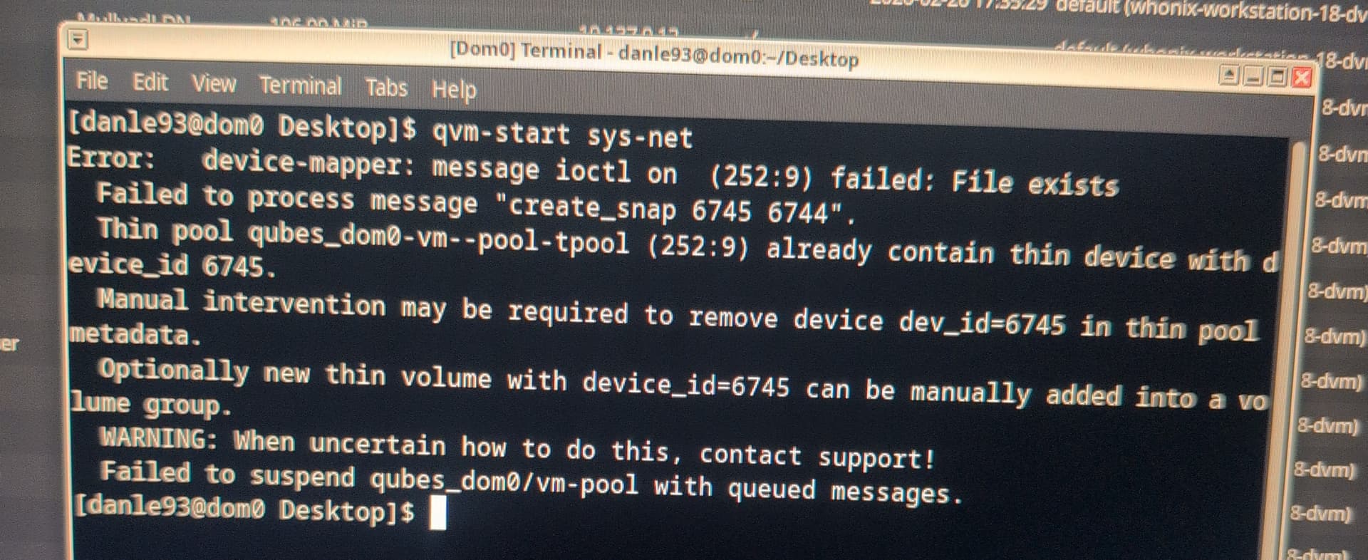

[user@dom0 Desktop]$ qvm-start sys-net
Error: device-mapper: message ioctl on (252:9) failed: File exists
Failed to process message “create_snap 6745 6744”.
Thin pool qubes_dom0-vm–pool-tpool (252:9) already contain thin device with device_id 6745.
Manual intervention may be required to remove device dev_id=6745 in thin pool metadata.
Optionally new thin volume with device_id=6745 can be manually added into a volume group.
WARNING: When uncertain how to do this, contact support!
Failed to suspend qubes_dom0/vm-pool with queued messages.

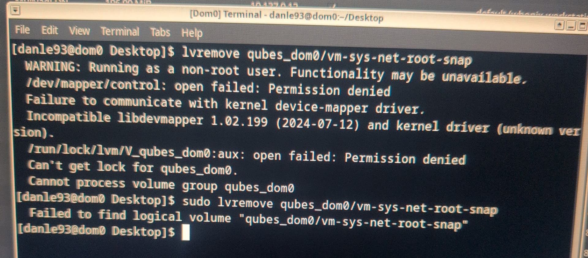

[user@dom0 Desktop]$ lvremove qubes_dom0/vm-sys-net-root-snap
WARNING: Running as a non-root user. Functionality may be unavailable.
/dev/mapper/control: open failed: Permission denied
Failure to communicate with kernel device-mapper driver.
Incompatible libdevmapper 1.02.199 (2024-07-12) and kernel driver (unknown version).
/run/lock/lvm/V_qubes_dom0:aux: open failed: Permission denied
Can’t get lock for qubes_dom0.
Cannot process volume group qubes_dom0
[user@dom0 Desktop]$ sudo lvremove qubes_dom0/vm-sys-net-root-snap
Failed to find logical volume “qubes_dom0/vm-sys-net-root-snap”
