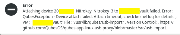

Hello QuBes Forum,
a new development with sys-usb
There is no way of attaching any USB Device plugged directly or via a USB HUB
No changes to the config of this system were done
and, everything was working fine
Where should i look to find relevant info to debug this error ?
in dom0, appVM (target), sys-usb (source)
Thanks in Advance
The redacted AppVM name within a /usr/lib/qubes/usb-import file.
I don’t understand your comment.
usb-import is a script in the TARGET-vault
The section of the script that generates the error messages is shown below:

in the TARGET-vault, there was no entries in the journalctrl at the error point
it seems that the problem is related to the TEMPLATE used by the TARGET-vault
having changed it to a different Template allows for the USB device to be attached
Nevertheless, I need to fix the problematic template now.
