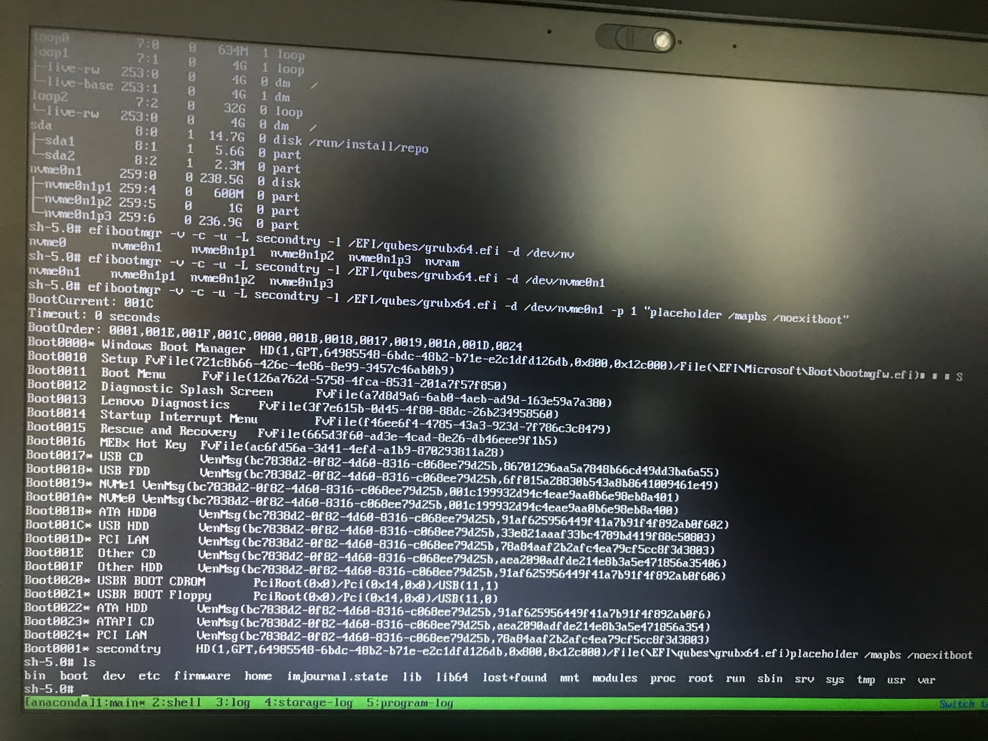

run this efibootmgr -v -c -u -L smlt -l /EFI/qubes/grubx64.efi -d /dev/nvme0n1 -p 1 "placeholder /mapbs /noexitboot"
and you can remove qubes entry by efibootmgr -b #### -B (change # to original boot number provided by running efibootmgr -v
after reboot, select smlt in uefi entry,

Still not booting
I have done As you said but when List the directory the \EFI doesn’t exist, see the it in the end of the image
no no, there’s no related to that, the uefi entry is good, so adding mapbs and noexitboot on uefi entry will not resolve your problem.
