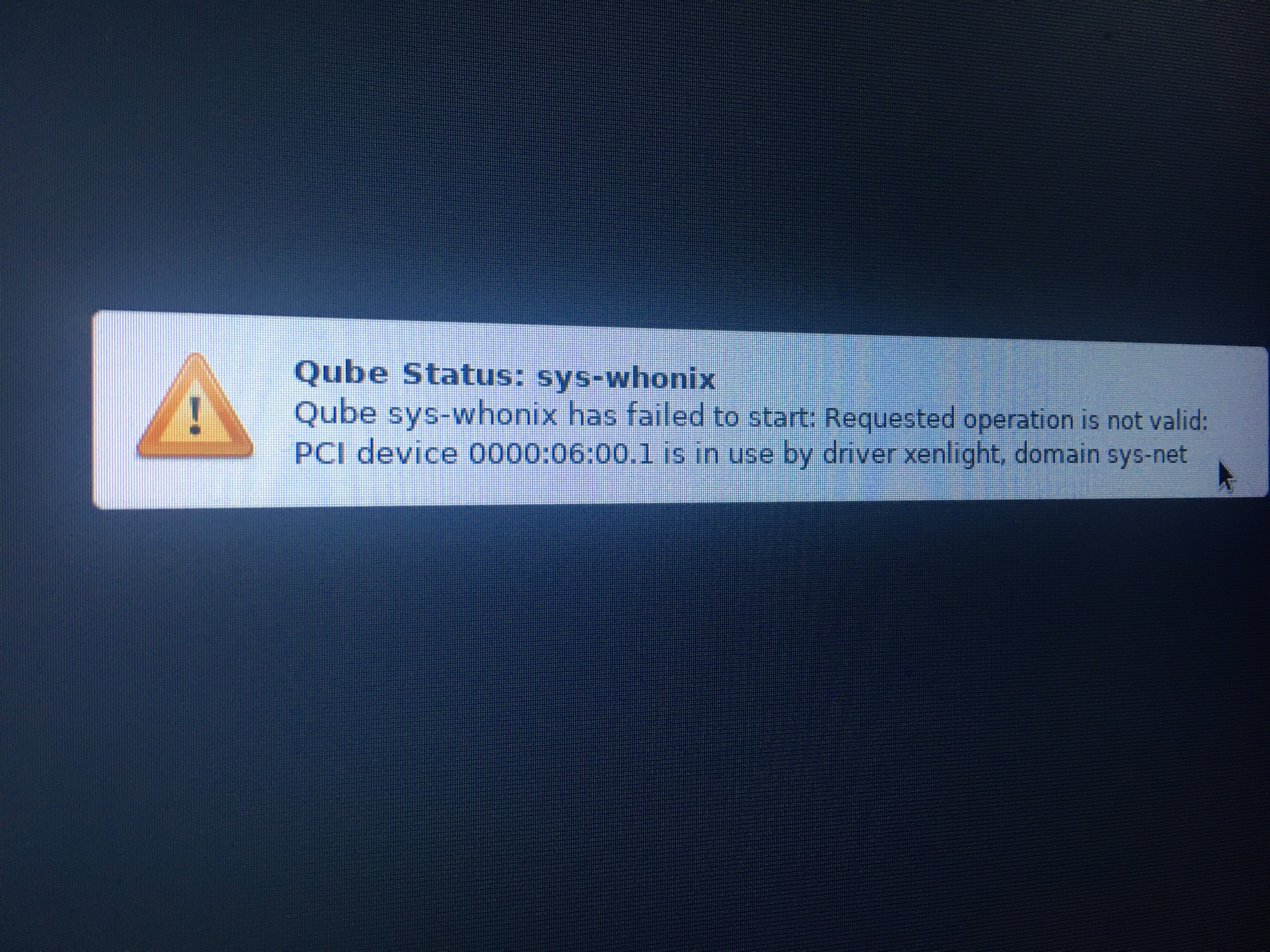

I’m on a fresh install of Qubes, and when I open an internet connected Qube I get this error.
Does anyone have any advice?

It seems your qube sys-whonix got assigned a PCI device (certainly a network interface), which is weird because it must be a HVM for doing so, and by default it’s a PVH qube.
Change the settings for sys-whonix, set it as PVH
I am almost 100% positive this couldn’t happen with the default install, customized or not during installation process.
In sys-whonix’ Settings-Device, device has to be removed.
