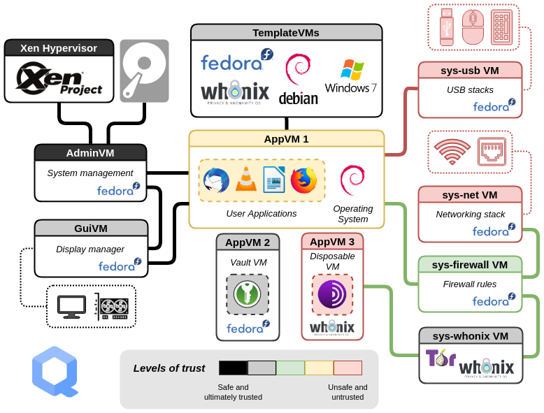

Does using PureOS or Trisquel in Qubes OS would improve security?
If so, do templates exist or should I use them as standalone vm ?
Iâm sorry to ask, but please be a little more specific: What do you mean by âimprove securityâ? Security [against|for] what exactly?
E.g.: Do you want to increase availability of service(s), improve the level of trust or simply be a little better protected against malicious attacks? Maybe something else?
Furthermore: Where exactly do you want to use it?
(Source: Introduction | Qubes OS )
