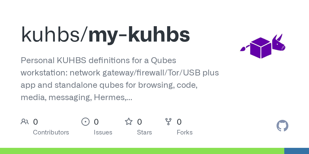

Simplest one: my-kuhbs/airgap at main · kuhbs/my-kuhbs · GitHub ← doesnt do much but install an apt package or two, and has no netvm
Bit more complex one: my-kuhbs/kuhbs-net-gateway at main · kuhbs/my-kuhbs · GitHub ← installs dnscrypt-proxy, wireguard and apt-cacher-ng
And so on. It should be reasonably easy to get how this works from clicking aorund, but I will publish on the website how it works exactly once its ready to be used.

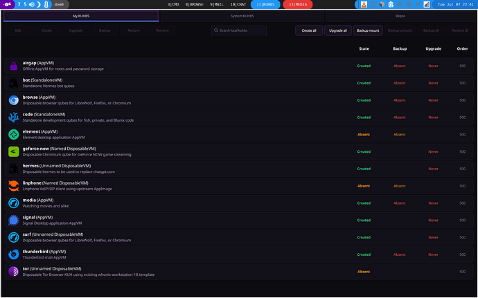

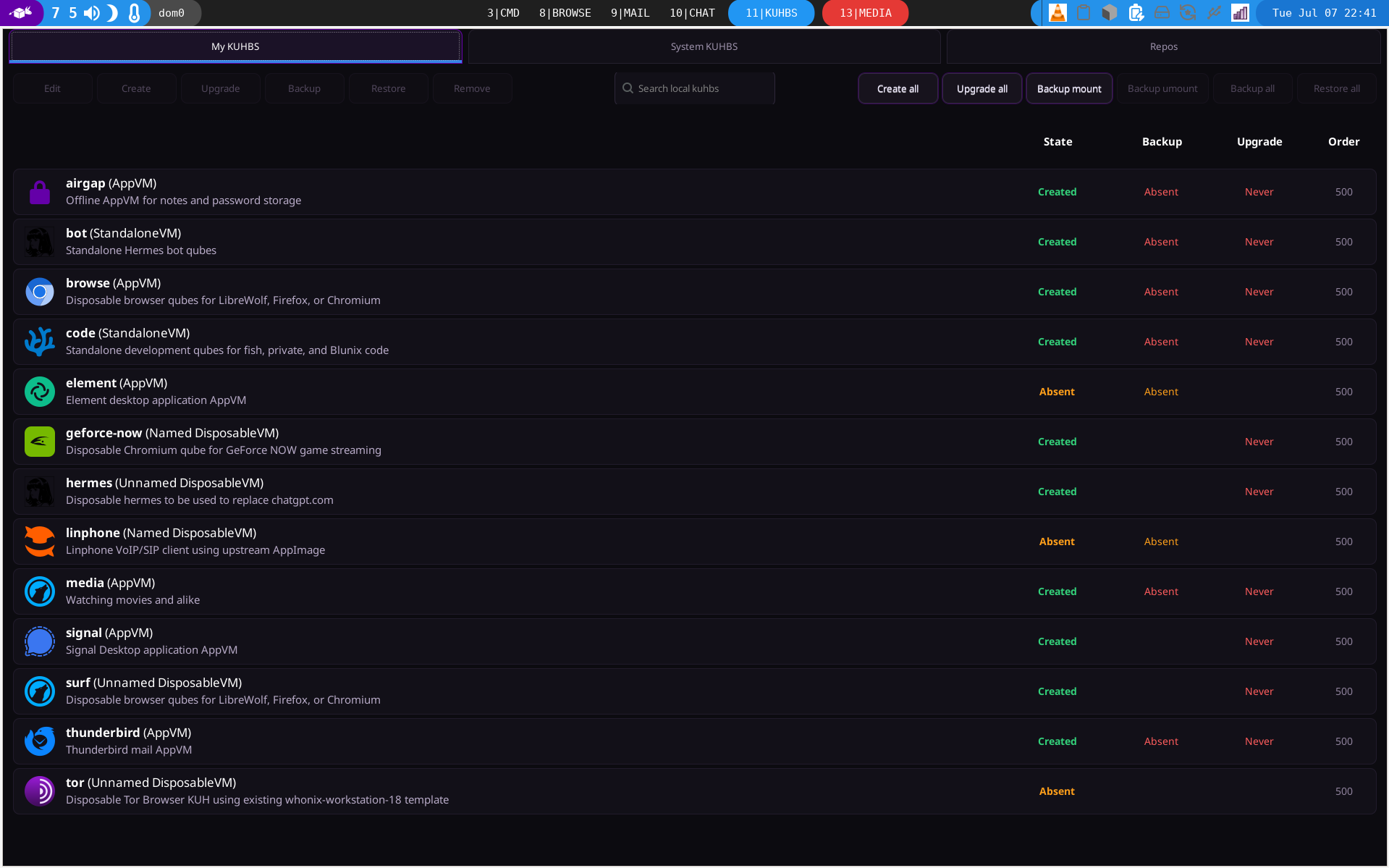

Kuhbs also manages updates (not just apt, but flatpak or whatever you write a upgrade hook script for) as well as backups.
“to stay fit” in my case means I know what I want and where to find the command for that, because it’s impossible to remember them other wise.
You are not exactly the target group. The target group are people who install Qubes and then kinda want to look at this (unfinished) gui:
(kuhbs has a cli too, which is also a good bit more powerful than the gui, the gui really only targets endusers).
