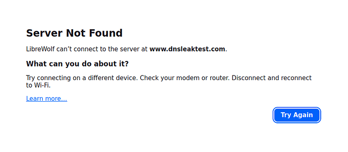

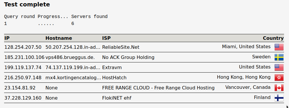

6. Test with test-vm:
Create a test-vm, set Net qube to sys-dns and visit dnsleaktest.com to confirm you are using DNScrypt resolvers and not your ISP’s DNS. You should see this:
If you stop dnscrypt-proxy service in sys-dns, internet will stop working in test-vm:

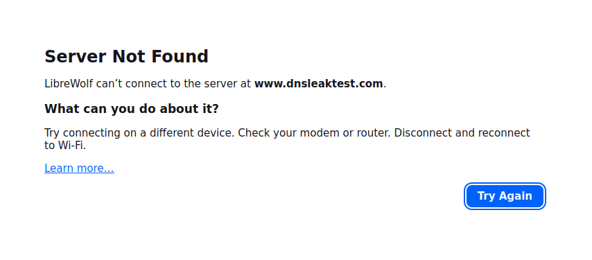

hey @linuxuser1 i followed your guide but it doesn’t work at all i got a error “code=exited, status=255/EXCEPTION” i think something is probably wrong with the toml file in your post
I used a fresh fedora 44 template
