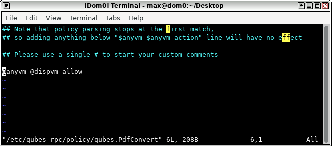

It seems that there is an error in the interpretation of the configuration file or am I missing something obvious?
Even tried with @ also
$anyvm $dispvm allow
The above is default, but why does it not work?
Sincerely
Max
They are the same
Do you have an answer to why they dont work and maybe a resolution to get it to work?
It seems odd to me it doesn’t work with the above configuration.
Max

Yep, something is probably wrong with your default dispvm or the set for your qube, as @alfonsius suggested
Perfect, That fixed the issue, thank you.
