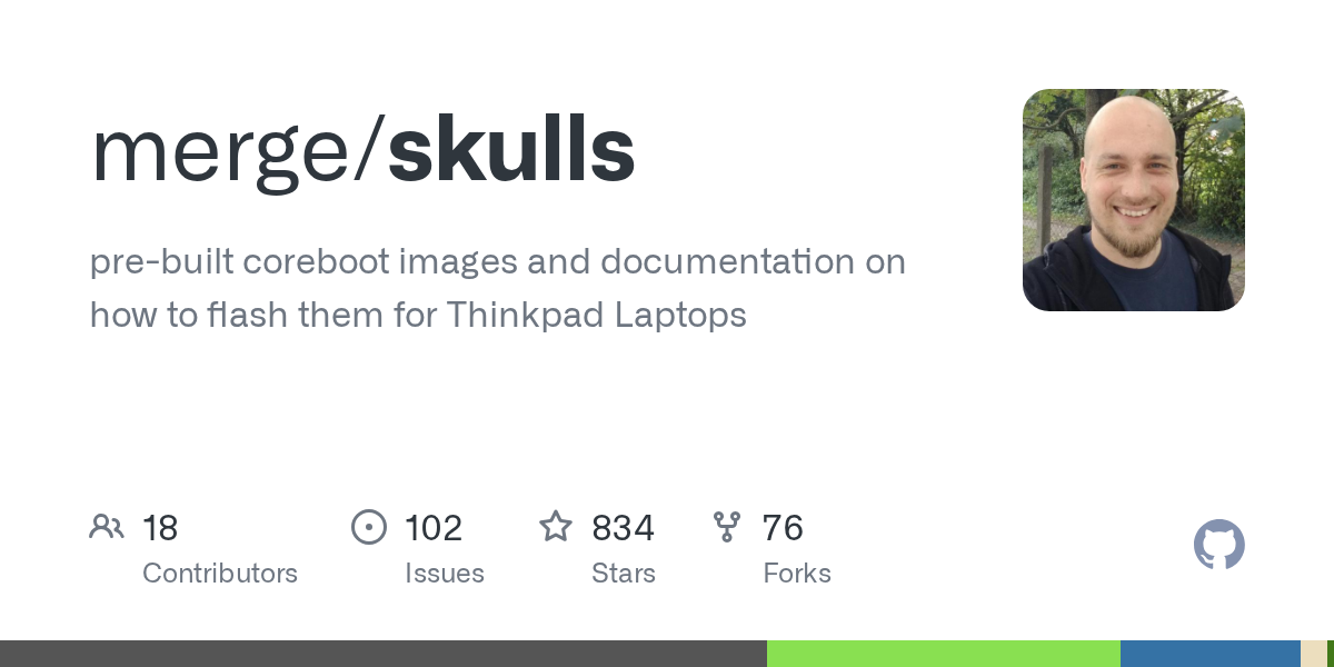

So Skulls is not recommended?
Why do you say this?
When I was at the point of using either Skulls, or building CoreBoot from current - someone said to use Skulls, as it used the latest CoreBoot, already assembled.
But you did not suggest Core Boot. Might be a place I went wrong.
