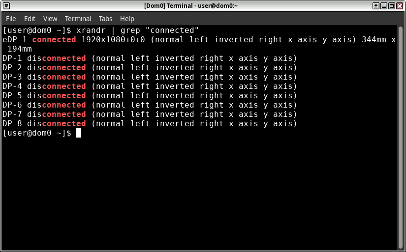

All tests were done on the same computer. This is the output of xrandr | grep "connected" in dom0 terminal:
Am lost because HDMI is not listed, in my case when disconnect my monitor have this
HDMI-1 disconnected primary (normal left inverted right x axis y axis)

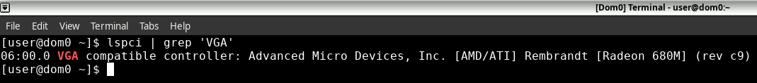

in your case don’t seems to detect HDMI ports at all, run lspci | grep 'VGA' to check your video controller
