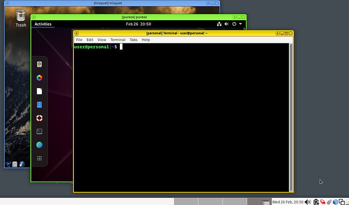

Can standalone vm be turn into disposable vm?
PureOS+Trisquel+Debian in QubesOS all working simultaneously and independently
