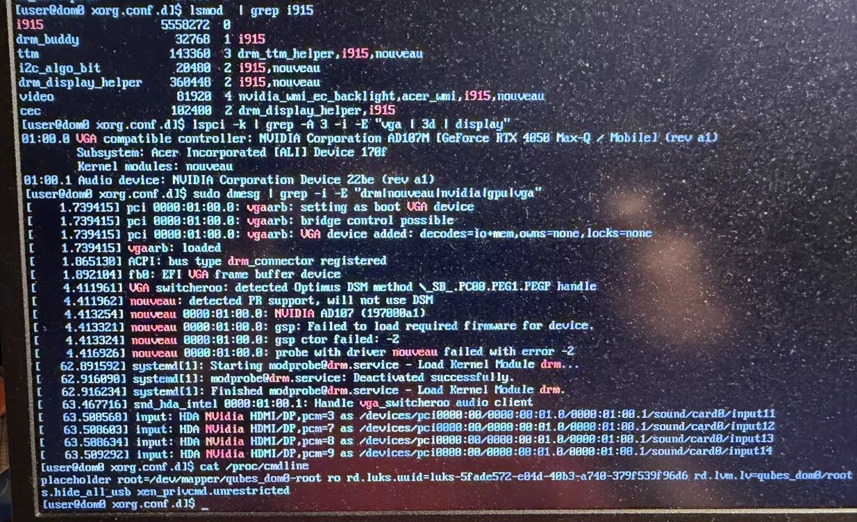

Symptoms
  • LUKS passphrase prompt degrades to text mode (plymouth graphical splash gone)
  • After decryption: black screen with blinking cursor
  • dmesg:
nouveau 0000:01:00.0: gsp: Failed to load required firmware for device
nouveau 0000:01:00.0: gsp ctor failed: -2
nouveau 0000:01:00.0: probe with driver nouveau failed with error -2
/dev/dri/ absent; /dev/fb0 absent on newer kernels; Xorg dies with “no screens found” on modesetting, fbdev and vesa alike
  • Notably hard to diagnose on Qubes: with no DRM device, logind reports CanGraphical=no for the seat, so lightdm waits indefinitely and never even attempts to start X — black screen with zero errors in any X or greeter log

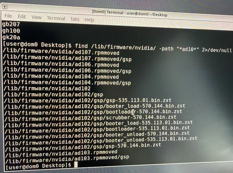

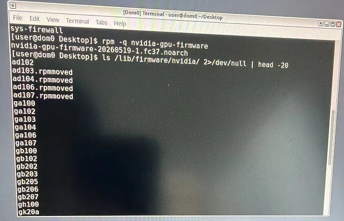

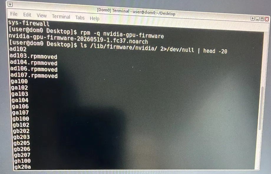

Root cause
$ ls /lib/firmware/nvidia/ | grep ad10
ad102
ad103.rpmmoved
ad104.rpmmoved
ad106.rpmmoved
ad107.rpmmoved
The package intends ad107 -> ad102 (firmware is identical across these Ada variants), but after the upgrade only the .rpmmoved backup exists and the symlink is missing. Nouveau looks up /lib/firmware/nvidia/ad107/gsp/gsp-*.bin, gets ENOENT (-2), and aborts GPU initialization.
Fix / Workaround
sudo ln -s ad102 /lib/firmware/nvidia/ad107
