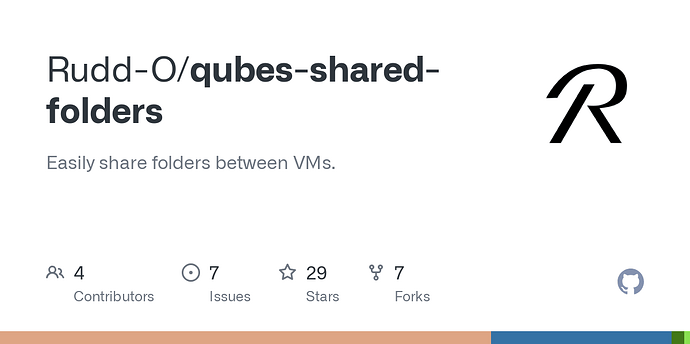

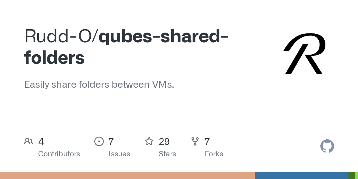

You mean like this?

@unman your sync solution is great for backups.
@AcidDemon the shared folders option is great if, for instance, you want an offline VM which can access, retrieve, edit, etc., documents or files from a networked VM.
