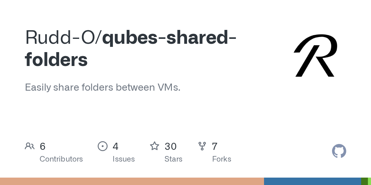

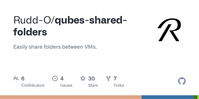

Is there any plan to implement something that would enable cross file sharing like:
There are various 3rd-party tools for that, including the one you listed. Currently there are no plans for built-in mechanism like that, as it significantly weakens isolation between qubes. Use at your own risk.
