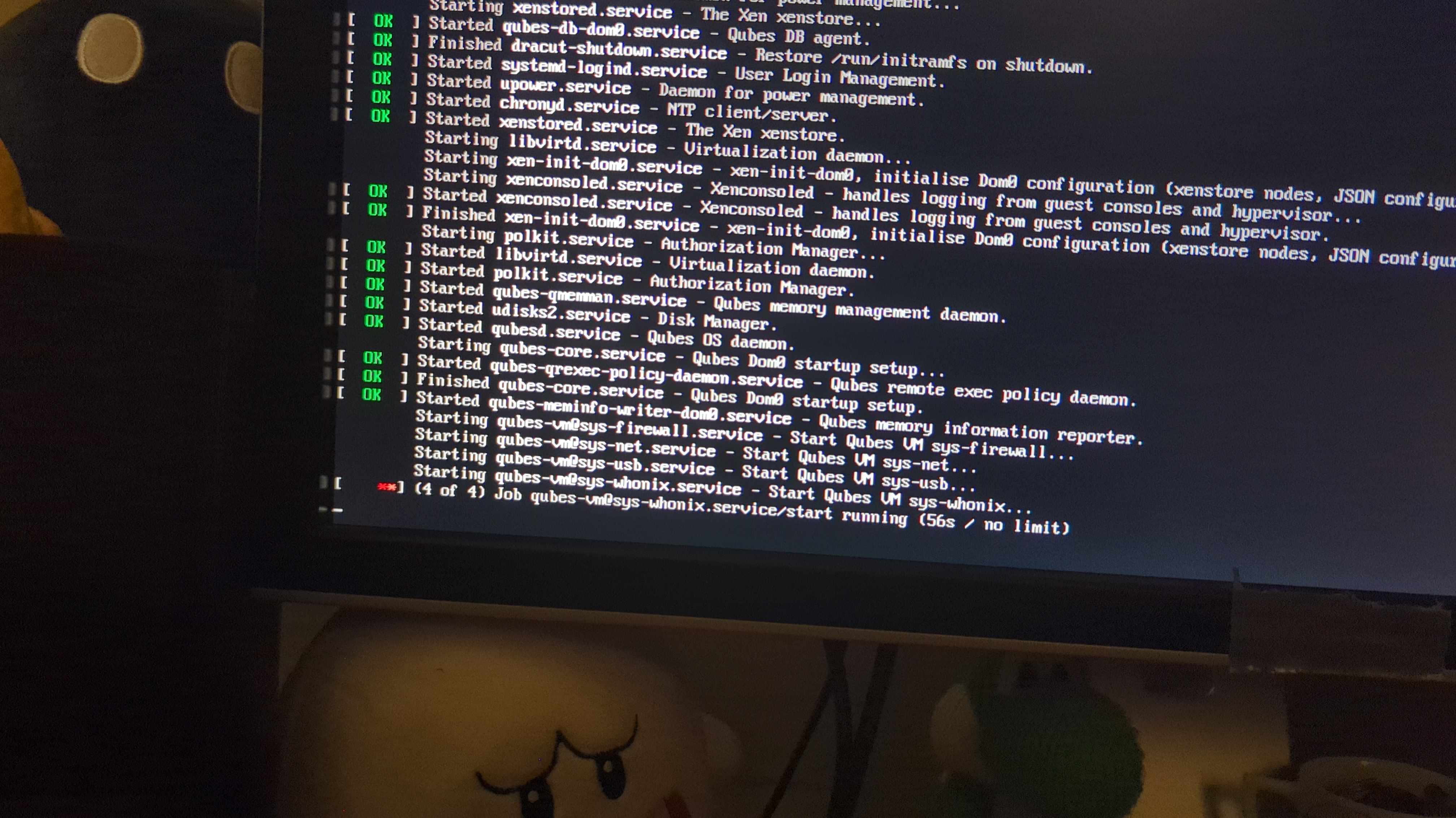

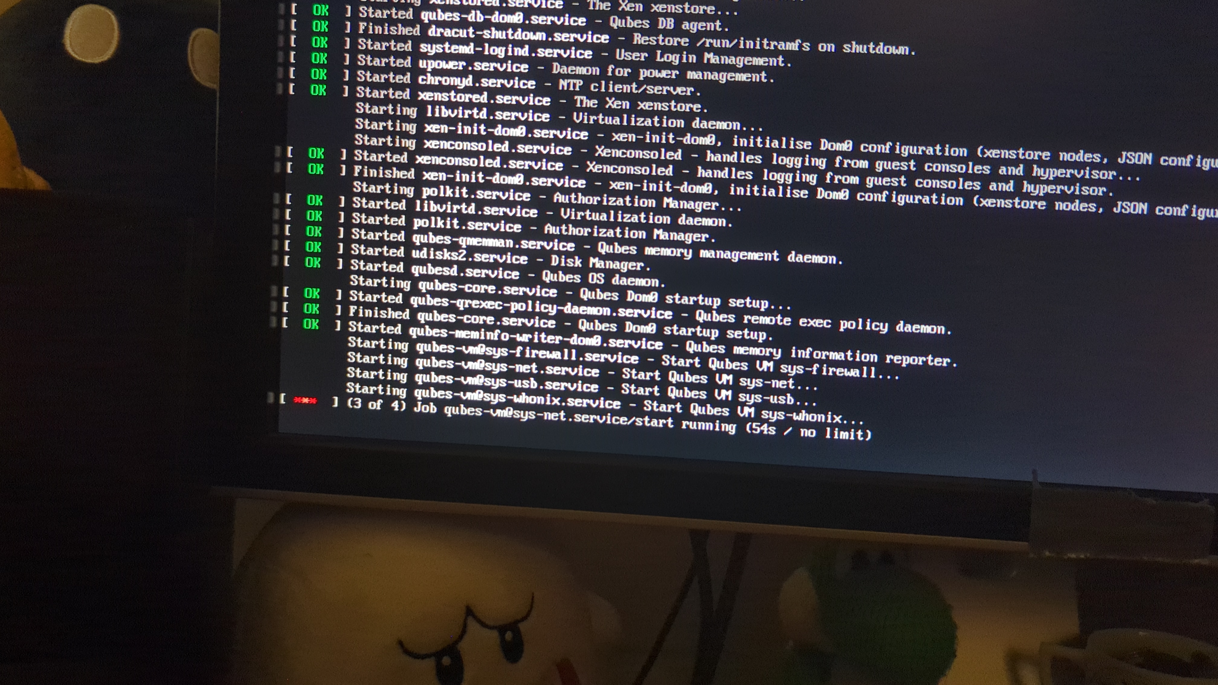

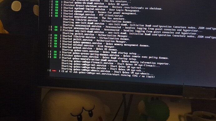

On Boot, “sys-usb”, " sys-net", “sys-firewall”, and " sys-whonix". I disaboed autostart on boot and i was able to use my keyboard but then i wasnt able to debug the issue properly
Here are some pictures of it failing

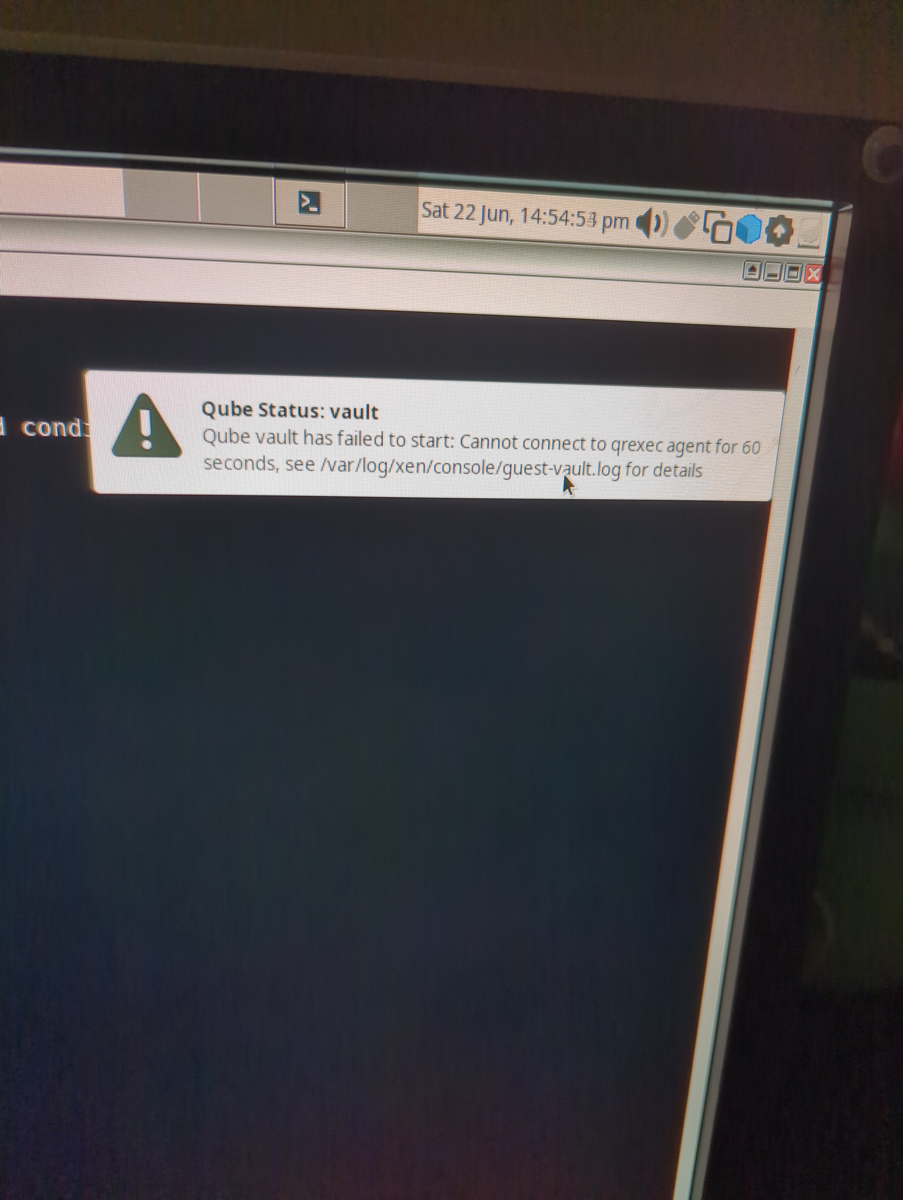

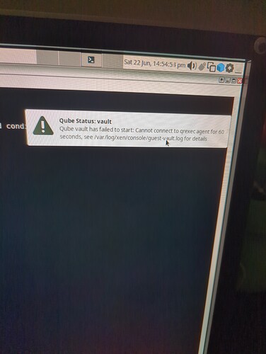

I think your template filesystem could be corrupted and you may need to fix the filesystem.
Check the file /var/log/xen/console/guest-vault.log in dom0 to see if there are any EXT4-fs errors like this:
