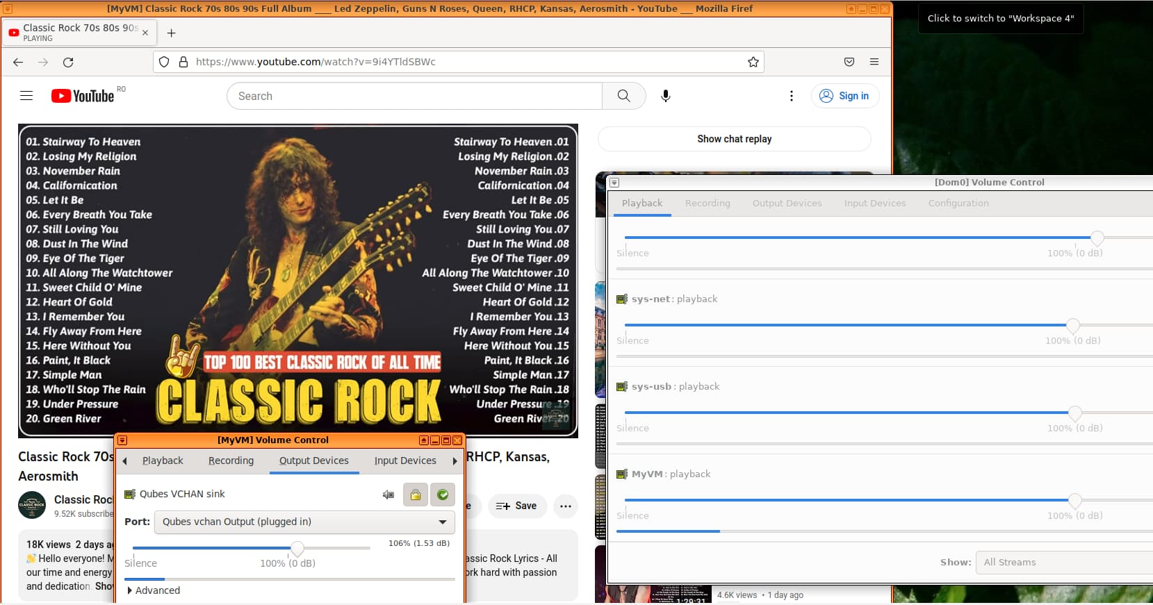

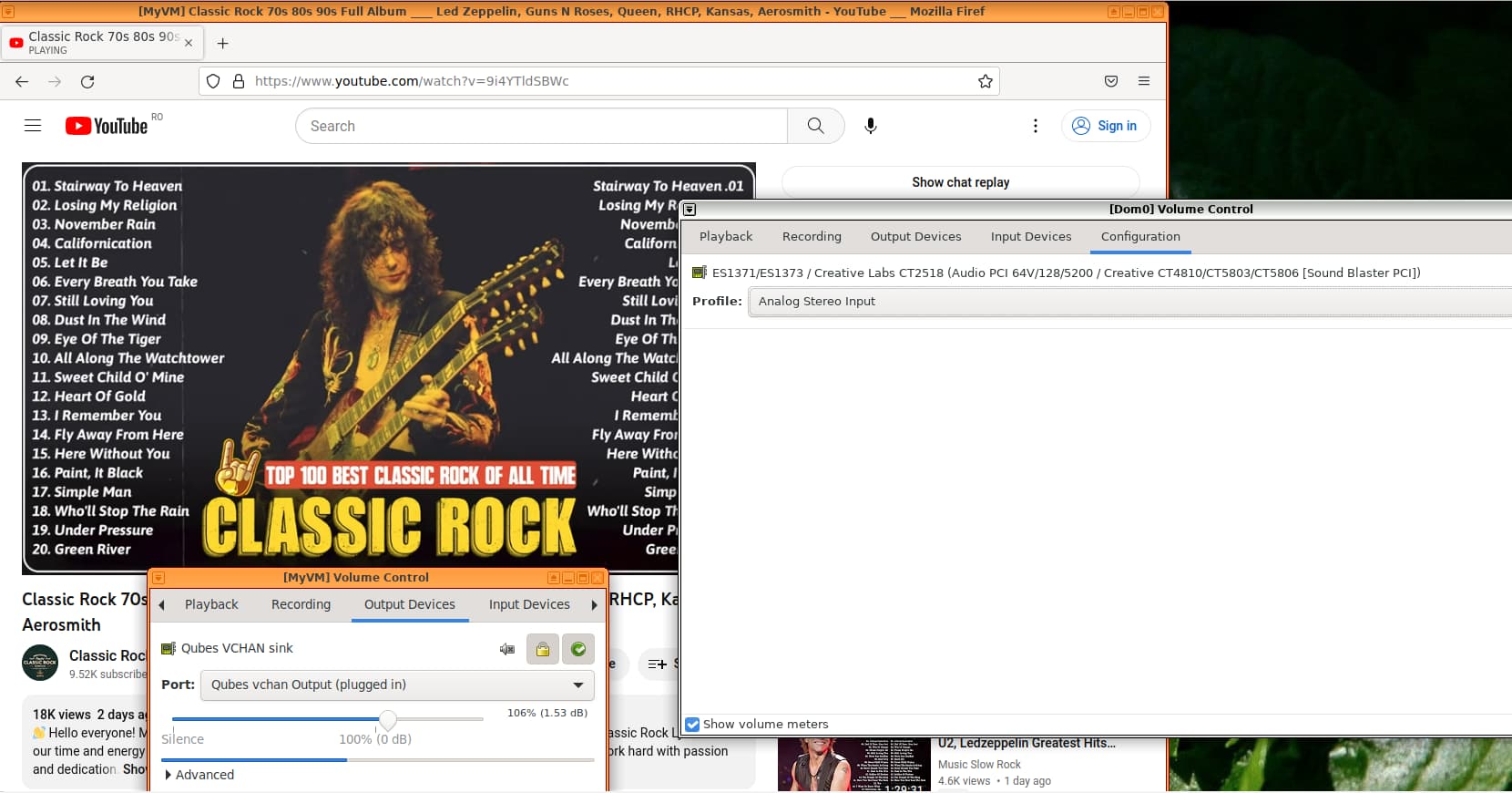

@balko i have added few screenshots, even if looks like everything seems to be ok, still no sound
@fsflover I have added in my VM(see in my screenshots)
@adw i think the problem is on the dom0.
Maybe dom0 lacks related firmware. What’s your soundcard’s spec?
@augsch is on the above screenshots

from the pict you send in some device you just need to click that profile, choose other one, then switch back.
go to input and output, do that above, likely fedora bug.

What profiles do you have in Pulse Audio Configuration tab for your audio device?
Select Analog Stereo Duplex profile if you have one. Or some other profile with Analog Output + Analog Input.
