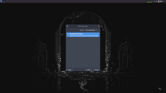

However, I noticed that the volume control icon still doesn’t appear in the dom0 status tray, and the media keys (volume up/down/mute) on my keyboard don’t have any effect. Is there a way to restore volume control integration in XFCE? Not sure if this is related to missing packages or configuration.

Do you have xfce4-pulseaudio-plugin installed in dom0?
Maybe you’ve removed a bit too much of the packages related to pulseaudio. Here are the packages installed in my dom0:

The issue is now fully resolved.
So, first, as @marmarek mentioned, I switched back to PipeWire since dom0 uses PipeWire instead of PulseAudio.
I ran the command sudo qubes-dom0-update --switch-audio-server-to=pipewire and verified that the necessary PipeWire sockets (pipewire.socket and pipewire-pulse.socket) were running.
Next, I followed @MellowPoison’s advice and installed the missing xfce4-pulseaudio-plugin package. This was required for the volume control icon to appear in the XFCE panel.
After adding the PulseAudio plugin manually to the panel, the volume icon appeared, and the volume keys (volume up/down/mute) began working again.
Thanks again to everyone for the suggestions and help! Really appreciate the guidance! :partying_face:
