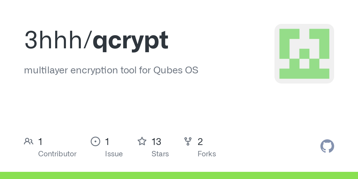

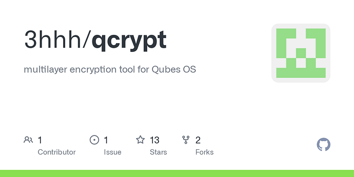

Yes, the qcrypt tool is something I came across while searching and it seems quite interesting BUT I don’t want to install something that I don’t fully understand in dom0.
